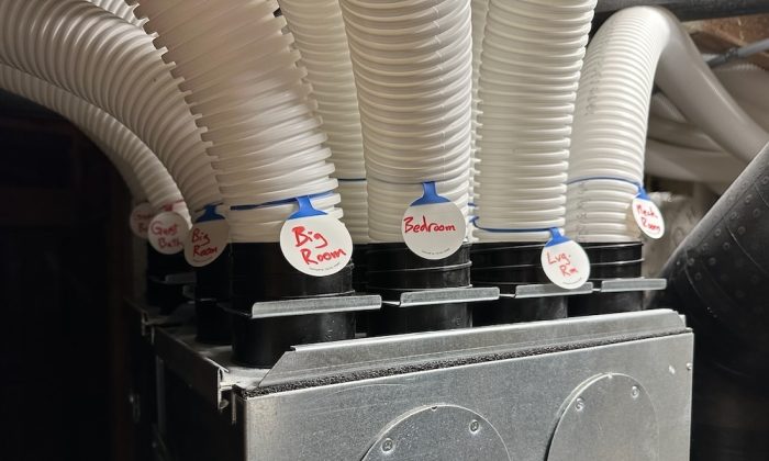

Zehnder ERV manifolds with ComfoTube distribution

We’ve got five extract vents in the house: one in each of the four bathrooms and one in the main kitchen. The nice thing about Zehnder ERVs is that they can run continuously at one rate and then boost to a higher rate when you need more ventilation. You can initiate a boost through the app, on the unit itself, or by pushing a boost button installed convenient to places where the extract vents are.

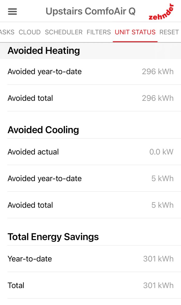

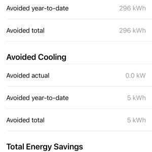

    1. jhrockwell | | #8
      The Zehnder app not only shows the energy consumed by the ERV to do its job, but also the avoided energy (in kWh) for heating and cooling.
