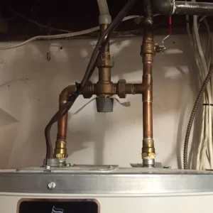

    The hot water tank/buffer tank is set to 140F — the thermostatic valve for DHW is set to 120F, the heat exchanger for the in floor radiant heat is set to 75F to 95F; the baseboard in the basement runs at 130F. In contrast the hot tub is set to 98F; cooking steak in the sous vide is at 125F.
    Maybe the question should be where do you control the DHW temperature? At the fixture or whole house/supply side?

    In Ontario, the code requirement is a mixing valve on top to keep the tank at 140 to kill Legionella and mix it down to 120 to eliminate scalding. I looked into this for an article and found that the US DoE says
    "And while there is a very slight risk of promoting legionellae bacteria when hot water tanks are maintained at 120F, this level is still considered safe for the majority of the population. If you have a suppressed immune system or chronic respiratory disease, you may consider keeping your hot water tank at 140F. However, this high temperature significantly increases the risk of scalding. To minimize this risk, you can install mixing valves or other temperature-regulating devices on any taps used for washing or bathing. "
    Given what you have been through, I wonder if it is worth the risk.

    DHW configurations vary and so does the risk. Given most homeowners aren't equipped to assess the risk, shouldn't the general guidance be to use higher tank temperatures with a mix-down valve? Yes, running a HPHW heater at a higher temperature will increase stand-by losses and decrease COP, but it's going to make only a small difference on the monthly utility bill. There are higher ROI efficiency choices to make than this one.
    My DHW setup is one where higher tank temperatures should be the recommended practice. My A2W heat pump pre-conditions my DHW via a desuperheater. The water temp in the 50gal desuperheater tank varies depending on the cooling/heating demand of the home and could sit for lengthy periods in the Goldilocks temperature range for Legionella. So the in-series, second "finishing tank" is at 145F (can't actually changes this on the Sanco I have), to ensure delivered water is safe.
    DHW recirc systems are also a potential site for Legionella. There's conflicting guidance on the risk in residential homes and what to do about it. For our system, I decided to install a Caleffi 116 thermostatic valve at the furthest point of the loop, near the point of use, so that very little hot-water is delivered to the return line. The recirc system is also triggered by an occupancy sensor and only runs for 1 minute. This hopefully keeps water temps in the return line low enough to make bacteria growth unlikely.
