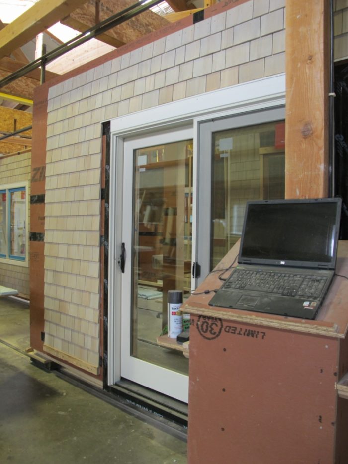

A Unity Homes wall section at the company's Walpole, New Hampshire, factory.
Image Credit: Alex Wilson
