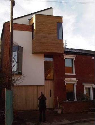

The addition to John and Jo Christophers’s 19th-century two-bedroom home in Birmingham, England, fills up side-lot space formerly used for parking.

The property shortly before retrofit work began. Radiators, a gas stove, fireplaces, original windows, and most of the existing plumbing system were removed from the brick house, which dates back to 1840. The extension was designed in part to improve the sun exposure for the home’s solar power system, which supplies the bulk of the building’s power needs. Most of the building’s energy efficiency performance, though, derives from the thorough insulation, and the superior windows and air-sealing, designed into the retrofit. A street view of the Zero Carbon House addition.

A recent New York Times article on the project noted that the couple purchased the house for about $200,000 and spent about $555,000 on the retrofit, which included removing the radiators, gas stove, fireplaces, and most of the plumbing from the Victorian; re-insulating and air-sealing the exterior walls; installing triple-glazed windows throughout; and constructing an addition that extends the building on one side (in space formerly used for parking) and up high enough so that the house next door doesn’t shade the addition’s pitched roof, which has a photovoltaic array and several solar thermal collectors.
