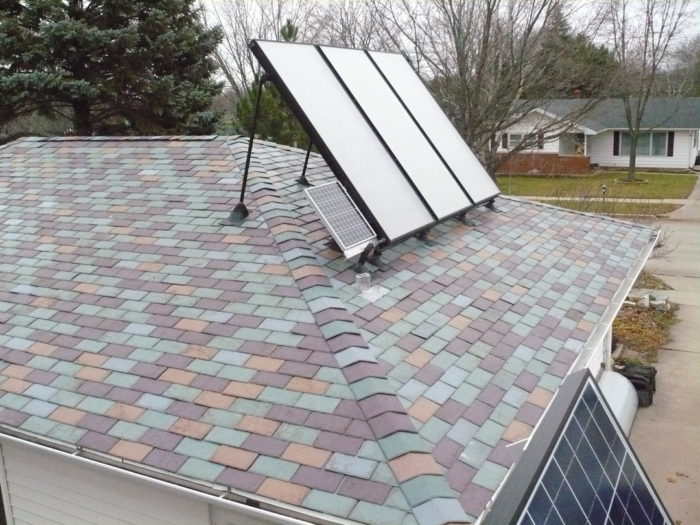

    Just scrolling through the stories and then I see a photo of my house long ago. Hmm? Nice article. I now have 4 Heliodyne collectors up there taking care of DHW & heating. All works great and we figure about 65% of the years energy used in our zero energy home and we're in dark & cloudy NE WI. Most of the solar thermal I install are ground mounts. Easier to trench than dealing with weak roofs and nightmare plumbing. I use mostly Craig's List/roofing contractors found collectors that work just as good as new 40 years later. Saves thousands of dollars for the customer and lots available from roof tear offs. At latitude 45 we need expensive additional equipment but new solar PV run variable DC pumps last forever. The only things I'm called to replace every 10 years is the anti-scald mixing valve needed as storage tanks can get near boiling without a well thought out heat dump.
    1. kevin_in_denver | | #24
      Reply to Paul Kuenn,
      It's good to hear that you are reusing older but functional solar thermal collectors. It's a great use of an undervalued resource.
      Unfortunately, when the system needs a new controller, pump or tank, the typical thermal system owner opts for system removal, even though it is probably the wrong decision. That's why there is a good supply of used panels.
