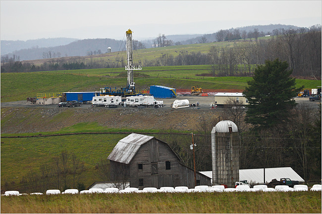

A natural gas well in the shale country of Pennsylvania.
Image Credit: Philly Workers Voice
