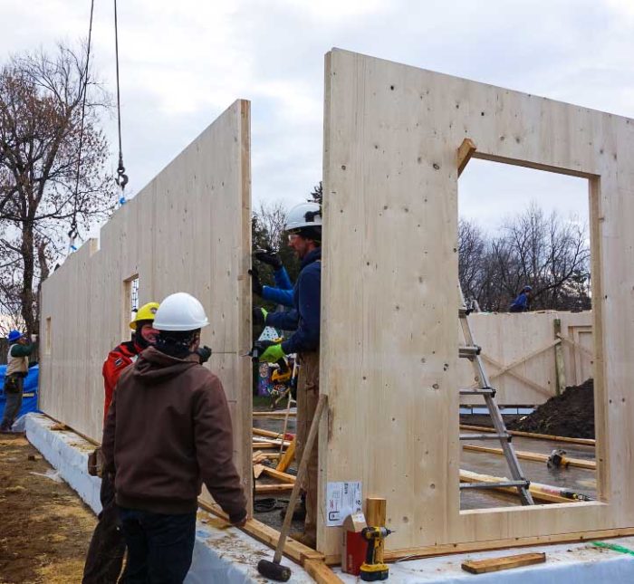

With preliminaries out of the way, the pre-cut wall, floor and roof panels are set in place
The exterior wall panels are 4 3/8 inches thick. They were set on the concrete foundation by crane, and will be wrapped in a layer of rigid wood fiberboard insulation.

Our plan for the cross-laminated timber (CLT) construction process was to do one floor a day. As days are short in December, and darkness comes soon after 4.30 p.m., we started as early as we could.
Wall panels are 110 mm thick (about 4 3/8 inches), to be insulated on the outside with rigid wood fiberboard. We started with the west wall, which had to be braced until other walls were put into place. Pieces were moved into position with a crane, and placement was crucial. Every millimeter counted, so the crane operator was a very important part of the team. [Note: See the images below for an abbreviated look at how the building was assembled. For a more extensive photo library, check the Wolfe Island Passive House blog.]
We had the wall and roof panels in a rack and stacked in piles. Keeping the process moving smoothly meant knowing where each one of them was located.
Each external wall and ceiling piece has a gasket on the edge so the structure will be airtight when complete. Each piece is joined to the others with 200 mm (about 7 3/4 inches) steel screws. By the end of the day we had done exactly what we had hoped and planned for: a complete first floor! (See Image #2, below.)
The second day of our build brought another overcast sky but, thankfully, no rain. And we got even more done than we had hoped for (see Image #4, below), so that on the third day we we would only have to install the roof panels (see Image #6), saving a significant amount of money on overtime (for the crane and operator, at least). More important, we will have managed to do what fully trained crews in Germany and Austria do in just about the same amount of time.
So, in two and a half days we completed the main CLT structure, and also tidied and rearranged the site to be ready for the next week’s work. Everyone did a fantastic job. A special thanks goes to Mike, the crane operator from C.A. Peters. He had to switch constantly between being bored for long periods of time and then having to do precision lifting. All the while he dealt with a whole lot of different people, not all of whom were experienced with big cranes and the signals needed for their operators.
