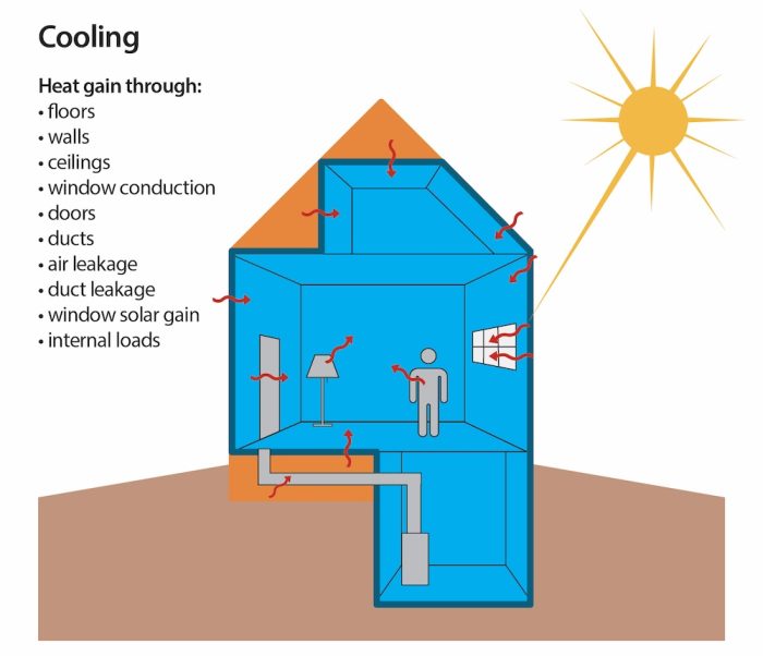

Yeah, I’m talking about a heating and cooling load calculation. Or in HVAC-speak, an ACCA Manual J. It’s a way of calculating how much heating and cooling a house needs. The calculations use the details about the house to determine how much heat leaks out of the house in winter and how much heat the house gains in summer. And yeah, I’m really saying you don’t need them—in certain situations.
