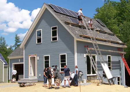

Inspired by a farmhouse One of five entries in the Zero Energy Challenge, this home was designed and built by Transformations, a green-construction specialist based in Townsend, Massachusetts. The builder originally aimed to construct a 3-bedroom, 1,232 sq. ft. home with a HERS rating of 35 or less and a sale price cap of $195,000. Transformations president R. Carter Scott says, however, the HERS rating should come in at zero.
Image Credit: R. Carter Scott
