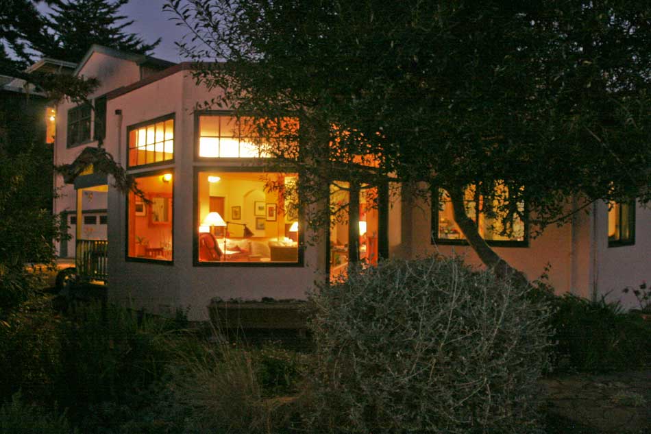

ATTRACTIVE BUT UNPRETENTIOUS. The multifaceted addition with its large, well-proportioned windows has become the centerpiece of this modest home. The addition nestles into the existing landscape easily with its small, 200-square-foot footprint.

A small addition and an extensive renovation helped this Bay Area 1940s kit home truly take advantage of its prime location. The south side of the home faces a beautiful section of the Golden Gate National Recreation Area. However, with no south-facing windows, the main living areas previously had limited views of the scenery and limited access to natural light. A 200-square-foot pop-out addition created a bright, high-ceilinged seating area with windows oriented to the south and southwest. The renovation included installing larger, better-placed south-facing windows to give an existing bedroom greater light and views. The new glazing gave the house more solar gain in winter. The new window configuration has also enhanced natural cross-ventilation through the house. Neither summer shading nor air conditioning is needed in this temperate climate.
