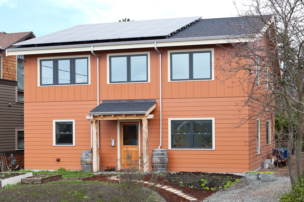

The home's compact shape conserves energy and reduces construction costs. The south-facing roof has room for additional photovoltaic modules, which could be installed in the future to help charge an electric vehicle.

The housing bubble had burst, the banks weren’t lending, and we were newlyweds who had no business even thinking about building a custom home, let alone Seattle’s first net-zero house.
By Eric Thomas
We were attracted to an empty south-facing lot, one of the last undeveloped parcels in our neighborhood. Were we naïve to think we could make our dream of an affordable green home a reality?
“Mom and Dad must have paid for that one,” one of our elderly neighbors told me when I met him for the first time.
He was commenting on the new net-zero-energy home we had just moved into, apparently assuming that it had cost a small fortune to build. I told him that our house was actually much less expensive than most new houses in the city, but I could see by the way that he was skeptically eyeing the array of sleek new photovoltaic (PV) panels on the roof that he didn’t believe me.
Perhaps my neighbor can be forgiven for doubting me. What I’ve come to discover over the last year — during which time my wife Alex and I moved into our new home and opened it up for several public tours — is that green building has an identity problem. Many people I talk to think it costs exponentially more than standard construction.
And who can blame them? The most publicized “green” homes are usually custom jobs — big, beautiful, modern, and totally inaccessible to the average homebuyer. Think affluent retirees or newly minted dot com millionaires.
When Alex and I decided to build a home, we went a different route because we had to. We knew we couldn’t afford a modernist masterpiece coming in at two or three times the average cost per square foot to build. In fact, we couldn’t even afford the average.
At the same time, we were committed to making the smartest choices our budget would allow. We knew this would be an opportunity to create a home that saved us money on energy bills for many years to come.
Net-zero versus Passivhaus
For most people, planning a house involves compromise. Lots of it. In our case, we chose to put our money into making the shell of our house tight and the R-values high. For everything else, we tried to choose efficiency and practicality over glam, with an emphasis on enduring style and simplicity. We could always upgrade the cosmetics later, but it would be extremely expensive to replace all our windows or undo a poor choice in insulation.
After some searching, I found Ted L. Clifton, whose company, Zero Energy Plans, was based on nearby Whidbey Island. My wife was out of town, but I immediately drove up to meet with him and to see some houses he had designed and built.
Driving between building sites, I asked him about the Passivhaus standard I had once read about and if his houses were different. He explained that Passivhaus seeks to minimize mechanical heating requirements. His designs, while also taking advantage of passive solar gain and high levels of insulation, seek the most cost-effective route to reach (or surpass) net-zero, even if it requires a mechanical system larger than what one would find in a certified Passive House.
While I appreciate the minimalist approach the Passivhaus standard takes to mechanical systems, I found myself gravitating toward Ted’s no-holds-barred, pragmatic approach to reaching net-zero, the “standard” that was most important to me.
We decided to go with one of his designs for an open-floor plan, three-bedroom, two-story home, 1,915 square feet in size. It was to be constructed of structural insulated panels (SIPs), which were manufactured by Premier SIPs just south of Seattle out of EPS foam and OSB plywood. We bought a set of plans for $1,275 and had Ted modify them slightly to save on construction costs and let in more light.

    Good Energy Performance - Could Visual Aspects Be Better?
    I'm an architect who is very focused on building performance and functionality. I really struggle with architects who are focused on creating an art object and little more than that. Having said that, I am disappointed by the looks of this building. The windows on theleft of the second story seems ill-proportioned in relation to two in the double-height space of the great room. And all of the windows are shifted somewhat to the left side of this south-facing elevation. Could the windows of the great room - or at least the ones to the right have been shifted a bit more to the right?There may well be very good internal reasons for this that I can't see without talking to the owners and/or designer.
    I congratulate the owners for building a zero-net energy building. I know this wasn't easy. I do wish there was more attention to resolving the exterior visual elements of the building. The elevation shown just looks kind of awkward to me. The interiors look quite nice. As a good example of relatively low-cost housing that looks good, I recommend taking a look at http://www.siegelstrain.com/projects/resourceful-building-project/.
  6. GBA Editor
    Martin Holladay | | #6
    Response to Bill Burke
    Bill,
    The owners live inside (and look at their house from the interior).
    It's the neighbor across the street who looks at the exterior.
    Since the owners pay the bills, they get to put the windows in locations that work best for them -- rather than for the neighbor across the street. That's as it should be.
  7. Lizzieplants | | #7
    House Exterior
    I have to agree with Bill on the exterior of the house. Good design and proportion is important and is not necessarily more expensive. The resale value of a house is in large part determined by how it looks from the street.
  8. user882465 | | #8
    Putting the Windows Where They Work Best
    Martin,
    My point is that I'm not sure the windows were located so they work best for the people inside. I think the designer didn't think all that much about it. One aspect of good design is mediating concerns that might at first glance seem to conflict, but don't have to. I don't think much effort was expended to resolve the interior requirements AND produce a pleasing exterior in this case. I know many buildings that work very well for the occupants and look quite nice from the exterior. It's not like you can only do one or the other.
    It's a clunky looking building. There are a great many clunking looking buildings in the world. I'm glad this clunky looking building has fantastic energy performance and I'm greatful to the owners that they cared about that deeply. But I'd rather have buildings with great energy performance that work well for occupants and where the owners and designer take a bit of time to have the building look fairly nice too. I don't think those three things have to be in conflict.
  9. jinmtvt | | #9
    Congratulations to the owner/designer on achieved figures
    I am wondering how the exact same building would perform in a zone 6+ or 7 climate ??
    It seems like this building was not overdone for this specific condition, which is something quite hard to achieve even with complex calculus.
    Though i have to agree with Mr Burke,
    the exterior design is reminiscent of far north isolated shacks more than a high performance residential. What is the orientation of the fascade ? ( is it mentionned somewhere? )
    i guess it would be close to south facing because of the PV panels ??
    Then why wasn't an overhang provided for the 2 bottom windows ??
    The diminutive front door cover should've been from left to right and done with a suitable covering.
    I don't see any possible reason to leave any 45degre and higher sun directly into any residential building .
    Aside the exterior aesthetics, the building performs and that is the main point.

  15. user-1083407 | | #15
    Window Placement
    I just wanted to note that the windows are shifted to the left because we had originally planned to have a wood-burning or gas stove in the Southeast corner of the great room, and the chimney pipe would have gone in that section. As we neared the time of construction, we decided to put our money into purchasing the PV panels instead of the stove. I am very happy we did, despite the slightly off-center look of the front of the house.
