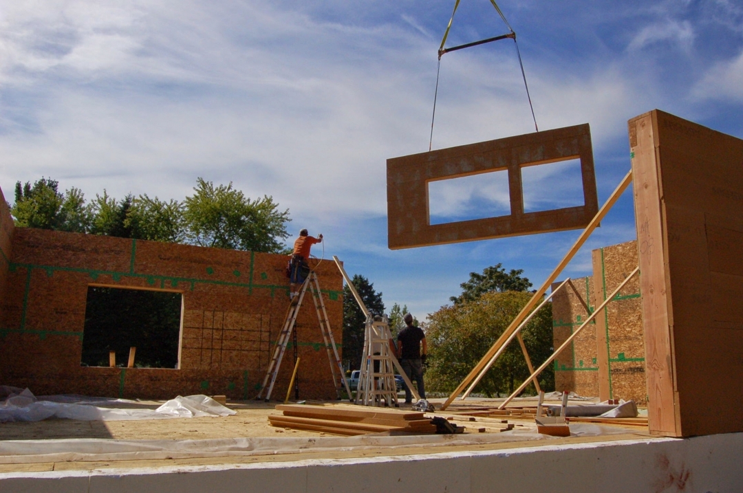

The wall panels were fabricated at an indoor assembly plant and delivered to the site by truck. The panels have 2x12 studs. The interior sheathing is conventional OSB; the exterior sheathing is 2-inch-thick fiberboard.

The A-Haus was assembled with pre-insulated wall and roof panels

Shipping vertically
On this home, all panels were shipped horizontally or (using industry jargon) “flat packed.” This proved cumbersome and time-consuming — a wide load permit was necessary, slight damage was inevitable during shipping, and the crane operator’s time was not used well. However, it proved to be a great learning opportunity. To fix this, Phoenix Haus now ships everything vertically via a specialized German trailering system. The Germans really do have it nailed down!
