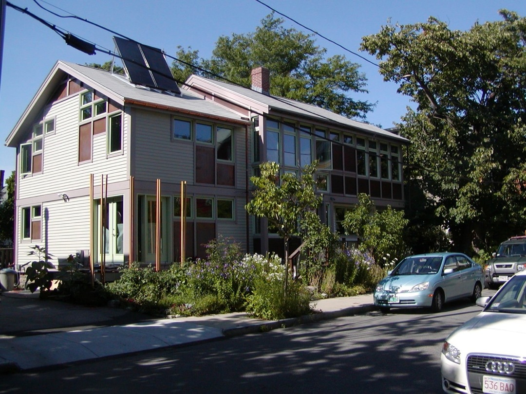

In this photo, the Phase II gut-rehab section in the foreground is now high performance and integrates with the Phase I right hand portion of the home. Note the two-panel solar thermal system, which provides the lion's share of the home's domestic hot water needs. The vertical bare wood pillars in the foreground are part of a trellis-hand rail detail for the corner deck, still under construction.
