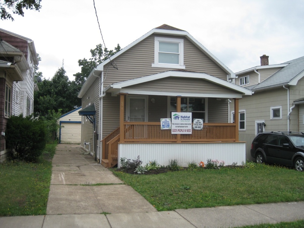

A typical Buffalo Habitat for Humanity gut rehab final product - an affordable Energy Star home.

Don continues: “We do every home in much the same way: we work almost exclusively from the inside, taking everything down to bare studs. Every home gets new heating, plumbing, electrical, insulation [and air sealing], wallboard, and a new kitchen and bath set-up. Most of the work is done by volunteers with specialty work like plumbing and electrical being completed or at least led by tradespeople.”
A key to this interior approach is furring out every 2 by 4 stud on exterior walls to the depth of a 2 by 6. “Over time, this has proven to be the most effective and efficient way to meet our home performance goals. It’s labor intensive but inexpensive and relatively easy to do. And remember, we have the labor,” quips Don.
Other elements of HFHB green include tankless water heating, 90 – 92% AFUE furnaces, low-VOC paints and sealants, and airtightness around 2 -3 ACH50, and no central air conditioning. A key element of their green approach is EPA Energy Star and the USGBC LEED for Homes programs.

HFHB is committed to each and every one of its homes being Energy Star certified. “Typically, our rehab homes score between 57 and 60, and our newhomes about a 50 HERS rating,” says Don. “And our first LEED new home came in at the Gold level and was the first single family LEED home in Western New York.” Don and HFHB think that renovating or building small energy-efficient, comfortable, and quality affordable homes is just about as green as it gets.
