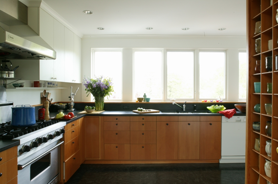

Bigger and brighter. Windows along one wall, light-colored cabinets on another, and a wide-open floor plan make this kitchen a great place to cook for a big family.

A mix of old and new. David worked his original appliances into the plan, including the commercial-style gas oven. The new counters—reminiscent of old lab tables—are made of Fireslate. The linoleum tiles are mostly made from plant-based materials—so are the wheatboard cabinet cases. Ginger chose white upper cabinets to reflect the already abundant light coming through the new windows.
