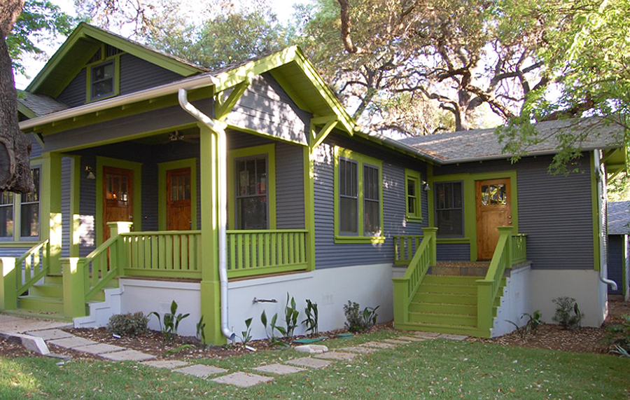

Historic Texas Bungalow Gets a Green Renovation
Adding without detracting. The modest addition to the right includes a master suite and an additional front porch. The goal was to meet the demands of a contemporary family without significantly increasing the home's footprint or compromising the vintage charm.

Nature and nurture. Though Austin is in a fairly warm climate, the mature oak trees shading this bungalow mean that the insulation and air conditioning don't have to work quite so hard. The previously uninsulated walls, joists, and rafters are now filled with open-cell spray foam, and the new 15.75 SEER HVAC system is sized to use a minimum of electricity.
A project that balances preservation and sustainability earns Austin’s highest green rating
This green restoration of a 1928 bungalow in downtown Austin was the first historic project to be rated by Austin Energy Green Building. While the aspects of green building are not new to our design and build team, meeting the historic requirements with green technology was.
We acquired this project as it entered the historic designation process and immediately began preparations to maintain the historic integrity of the house and neighborhood while creating an energy-efficient, comfortable, and healthy home. We believe that one of the greenest things a homeowner can do is take an existing home and update it to meet modern needs while reducing its carbon footprint.
