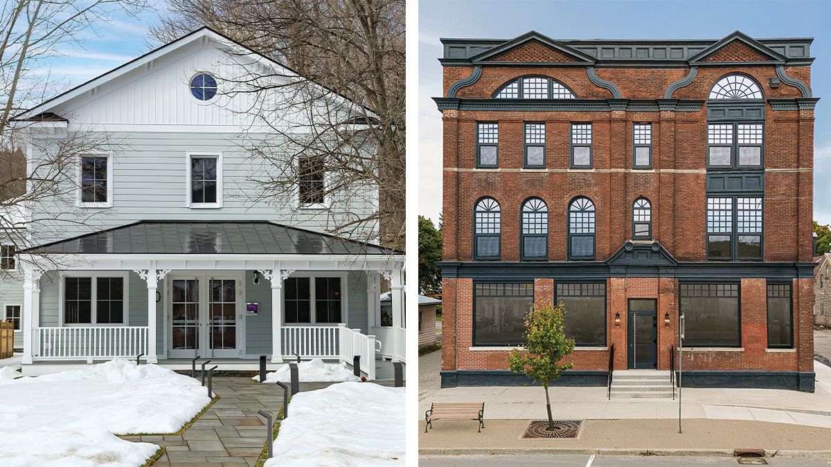

Chestnut Crossing (left); 16,000 sq. ft.; 13 rental units; Cooperstown, New York. • The Bank Lofts (right); 12,000 sq. ft.; 9 rental units; Richfield Springs, New York.
