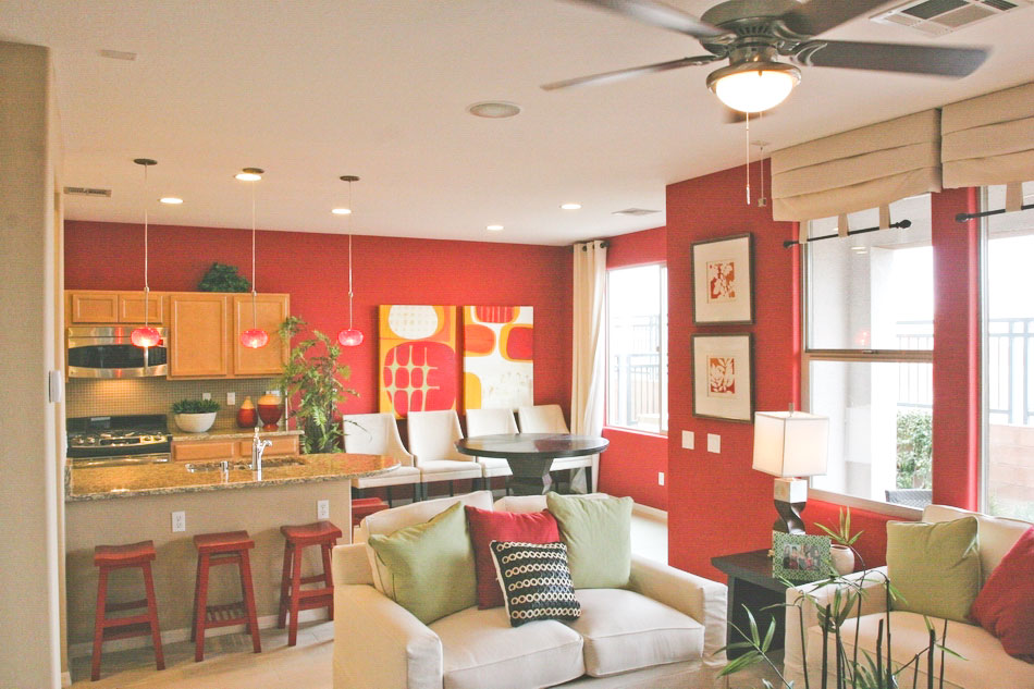

Windows working well. Because of the scale and layout of the Villa Trieste community, solar orientation wasn't specifically addressed when designing the homes. Still, the simple open plans let in plenty of light. They also make what might be considered a modest size home feel very spacious.
