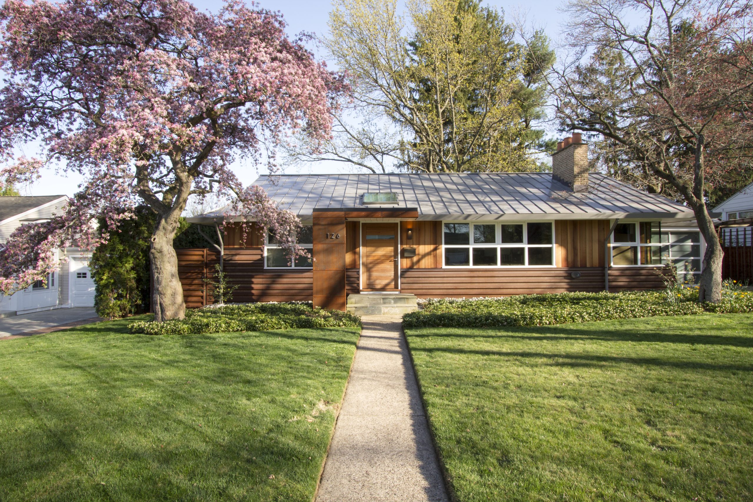

An architect and a handy homeowner team up for an exterior makeover with energy efficiency, comfort, and durability as part of the plan
The owner and remodeler of this mid-century ranch wanted it to stand out in a neighborhood of similar homes, and to improve its performance, too.

Our design/build team was hired by John, an ambitious, talented, and dedicated DIYer who wanted to upgrade his 1950s ranch and was willing to do most of the work. John wanted to embrace the good bones and inherent strengths that his house had to offer while modernizing the building enclosure and finishing the exterior to stand out in a neighborhood of similar ranch homes on quarter-acre lots.
As you’ll see, the house now has a tight building enclosure with decent levels of insulation, siding installed over a modern water-resistive barrier (WRB) with rainscreen details for drainage and drying, and a well-insulated vented roof assembly. The materials that bring the new exterior to life include a standing-seam metal roof, a combination of clear-finished vertical cedar and Corten steel siding, composite trim, and rebuilt windows. With low maintenance as a goal, materials like the metal roof and Corten steel…
