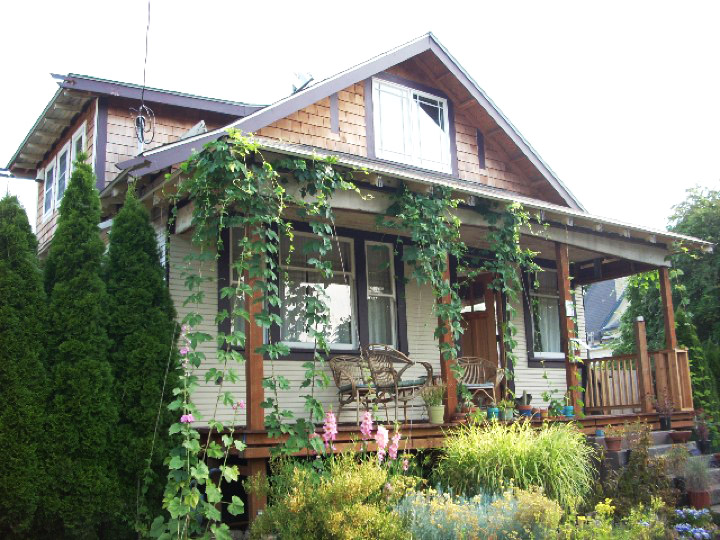

Dan Cote's home has gone from among the least to the most inspiring homes on his block on the east side of Portland, Oregon.
Image Credit: Dan Cote

A building consultant practices what he preaches by retrofitting his home for healthy and productive living
When Dan Cote bought this run-down property on Woodstock Avenue in Portland, he wanted to take everything he had learned about high-performance building and building science from his day job as a technician and consultant for Conservation Services Group and pack it into the structure and the lot. He pretty much lived in the middle of his work for the next several years.
Beauty and building science
Perhaps the most striking aspect of Dan’s project is how well he has combined all the technical details with a truly beautiful home, inside and out. From color schemes to flashing details, from plant selection to thermal bypasses, Dan’s home and lot show both right and left brain prowess.
On the outside, Dan dreamed up the eave-overhang green roof. “I spent a lot of time looking at my beautiful secondhand Doug fir doors out back, wondering how I could protect them without an overhang so low that it becomes all that you see,” Dan relates. “In the end, I decided, why fight it; do something attractive on the overhang.” The result is planter boxes full of hardy sedums, minimally attached and flashed in such a way that it does not affect the water management capacity of the roof. “The overhang is a stepped-down add-on to the roof, completely separate. I used a self-healing membrane on the overhang, gooped [sealed] each of the six fasteners securing the planters, and then left the soffit open to dry readily.”
On the inside, Dan’s big thing is durable, low-maintenance floor surfaces. “I really liked the pre-finished bamboo because it is a rugged, low-maintenance material, but I thought the kitchen needed something a bit more interesting as well,” says Dan. With a box full of tile odds and ends, Dan began planning a mosaic right in the center of the kitchen floor. Dan chuckles: “It was like doing a puzzle without the picture on the box.”
Dealing with a “hammock” roof
It is not uncommon for the rafters in old bungalows like Dan’s to be grossly undersized. His rafters were rough-cut 2x4s that sagged nearly two inches in the center. Dan got all but about 3/8 of an inch back in two ways: having each rafter bear directly on the new knee-wall studs (reducing the length of the rafter runs) and sistering both sides of each rafter with plywood gussets.
