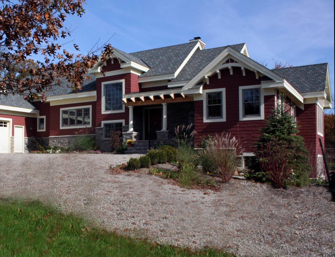

The impressive facade is clad in fiber cement shingles and cultured stone. A water permeable gravel driveway leads right to the front door.
