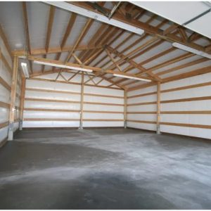

I’m a small organic farmer who tries to do things myself located in zone 5, ~2 hrs. north of Springfield, IL.  I’ve read over a lot of articles on this wonderful cite which kind of touches on the topic, in a round-a-bout way…  I have a pole shed that my dad had built in 2017 and there is vinyl face insulation pinched between the outer girts and steel siding.  I want to add insulation to the inside to make it more comfortable for winter work; probably won’t AC it in summer.  Am I good to put foam board against that and seal up or would it be best to remove it altogether?  Any advice or references would be appreciated.     Matthew

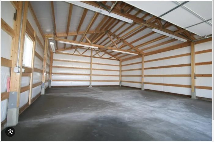

    Is something like the attached photograph what you are talking about?
    I would think so long as you have a vapor retarder (like taped closed cell foam, painted drywall, taped faced batts, etc) on the inside that you would be ok, no?
    1. mcurrier | | #5
      Yes, that is precisely what it is (our walls are 8' on center). I have read on other articles on "greenbuildingadvisor.com" that it's preferable to put the foam board on in side of the girts vs in between the girts. Would having this gap between the two layers be and issue, where I would be better off butting it against vinyl? Placing foam in between girts wouldn't seal as much but there is that extra layer on the outside so... Thanks again for you time today and all good ideas. Matthew
