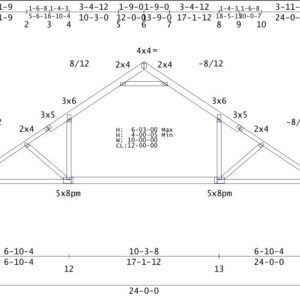

I am ready to insulate my home which is a new construction. I originally planned to spray the roof deck with open cell and the walls with closed cell but decided to switch to sheep’s wool. My main concern comes with insulating the roof deck. I have engineered trusses with a bonus room.
My plan is to vent the roof deck with baffles and fur out the trusses to achieve at minimum an R-38.
My thought is to use 2” rigid foam to construct baffles from the top plate to the ridge, which would also act as an air seal (if that would provide an air seal which is my main question), outside of that would go wool insulation.
would the rigid board between trusses provide an air seal or would I need to rely on something like drywall?
Should I be concerned with the uncovered wood members of the trusses?
My aim is to keep the air seal and insulation against the walls and the roof deck.

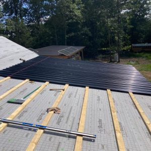

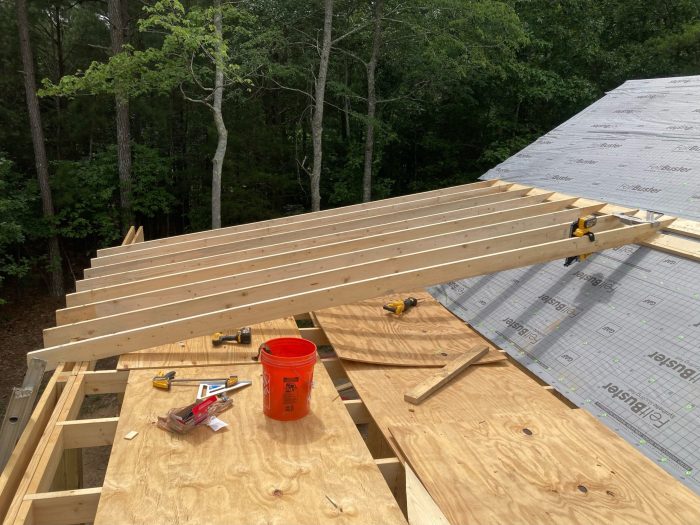

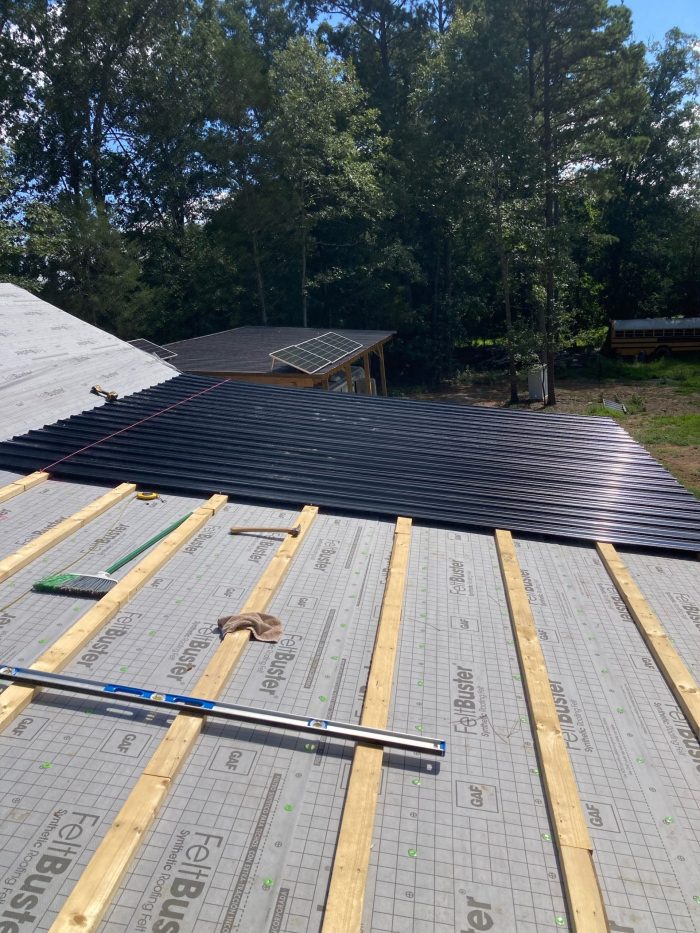

    3. Exterior continuous insulation – It is possible to remove my roofing (metal), install rigid insulation 3″ and reinstall the roof. The roof sits on horizontal 2×4’s 2′ apart. I could pull those up lay the rigid foam and reinstall on top (not ideal) or insulate around them, but those areas would have reduced insulation. Would that pose a problem? Also, I am unsure whether i could properly detail this type of assembly. The truss is designed with a bonus room
    *zone 4a zip 37370 Thanks in advance.
