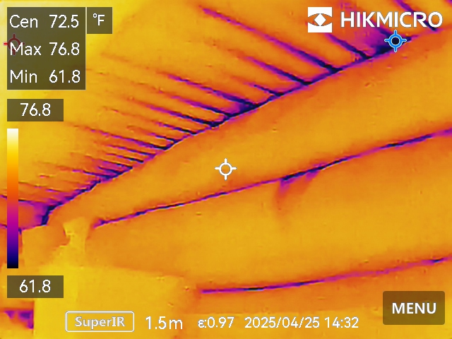

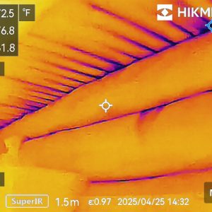

    I conduct about half dozen energy audits and building investigations on log homes a year. A problem that is consistent with nearly of them is how the roof air sealing is connected (and made continuous) to the log walls. This thermal image is from a log home I was at last week, a 2000 build at 10 ACH50, about double what I typically see from stick-built homes of the same era. A good amount of the total leakage was the wall to roof interface. Very difficult to fix after the fact.
    1. Malcolm_Taylor | | #5
      Randy,
      That’s the worry I was alluding to when I brought up the differential settlement of the gable walls and the log ones. The air-sealing connection between the roof and walls also has to take into account that the log walls will shrink over time, while the stick-framed ones won’t.
