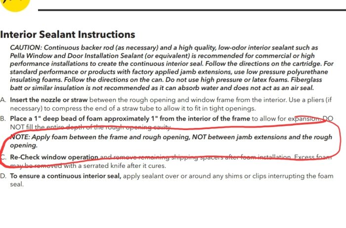

For our fiberglass Pella windows, we planned to air seal on the interior by inserting a backer rod before adding low expansion spray foam (to ensure a drainage gap was maintained). After foam, we planned to use backer rod and caulk to get a good seal.
They are windows with factory applied jamb extensions. We didn’t know this before they were installed, so we didn’t seal the seam between the window frame and jam extensions. We were hoping the spray foam would help with that.
But now I’m not so sure I’ve been  thinking about all this correctly. Pella’s instructions specifically say NOT to use any foam between the jamb extensions and opening. It’s only to be used between the window frame and the opening.
Does the air sealing need to happen back at the window frame itself?
If so, how can I effectively get back there to ensure it’s air sealed? And what do I do with the rest of that empty space in the opening (from jamb extensions inward)?
It’s a pretty deep cavity, and some of the openings are very narrow.
Would love some guidance here!

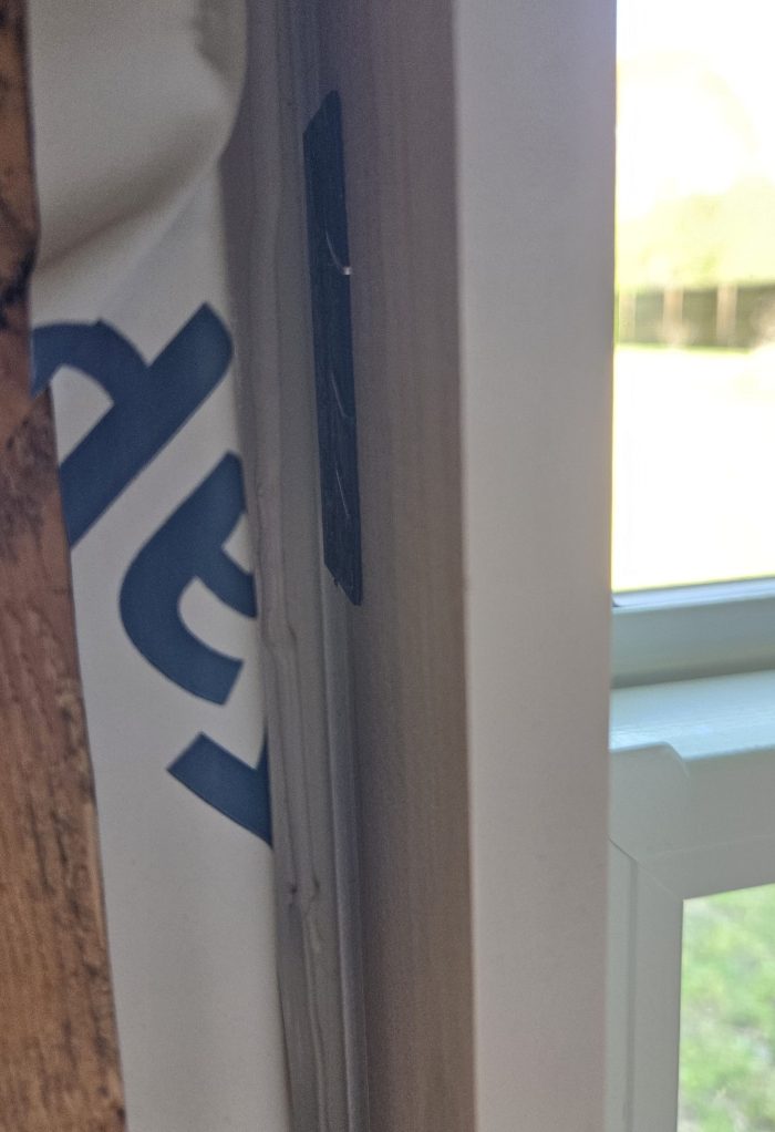

      I can reach back to the nail flange, but I want to leave a small gap toward the flange for drainage. Based on what we are seeing, the jamb extensions are ~2.5 inches deep while the window frame itself is only ~1.75 inches deep. Seems like an impossible task!

    The reason they don't want you spray-foaming behind the extension jambs is due to the risk they will get pushed away from the framing. If you fasten the extension jambs to the rough framing first, preferably with something that resists pull-out such as trim-head screws, you should be able to fill the gap with foam. I don't know of another way to make the window airtight otherwise. I would still try to leave the outer portion of the gap unfilled so it can drain a bit if necessary.
    Does your photo show the back of the nailing flange? If so, that's a huge construction gap. North American window manufacturers usually call for 1/4" construction gaps.
  3. tjones1014 | | #4
    Yes, that's the back of the nail flange. They just used the previous openings and called it "good enough" apparently. Some of the gaps get up to 3/4" wide. Just one of the many things we aren't happy about with this install.
