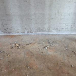

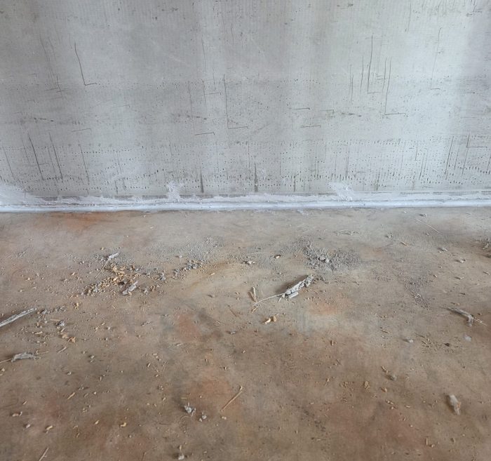

      1. tjones1014 | | #4
        We ended up using 1/4" cement board and plan to make it a continuous barrier from top to bottom. The seam at the bottom was tricky to try to seal with caulk so they ended up caulking the cement board, bottom plate,and slab together (pic attached). Is that ok, or is it setting us up for any issues?
          MALCOLM TAYLOR | | #5
          tjones,
          No it’s fine.
