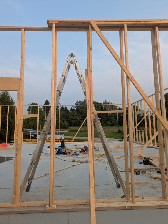

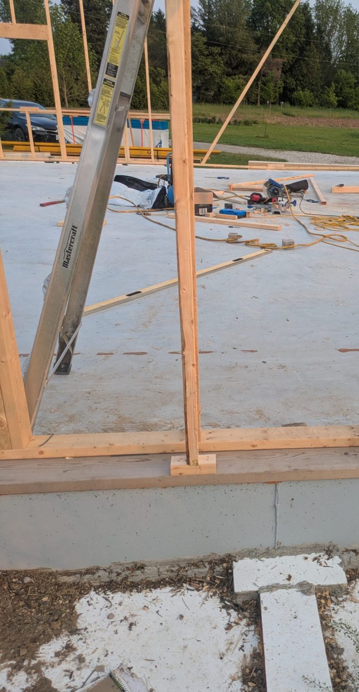

I finished the structural wall of my workshop, and installed the first section of non-structural wall. This design has a 2×4 inner wall that is structural, an outer 2×3 wall for holding the siding and WRB, with the two walls held together by 2×10 top and bottom plates and OSB gussets.
I was warned it would be time consuming to do it this way, and so far that has proven correct. However, it occurs to me now that there is a dead simple way of adding the outer wall that would be five times faster, and I can’t see why it wouldn’t work. Can I just delete the plates from the 2×3 wall, and instead make 2×3 I-beams that nail to the 2×10 top and bottom plates?
I will confirm this with the engineer, but I’m hoping to keep working on this through the weekend and he probably won’t respond before Monday. If I have a pretty good inclination that this will be ok, I’ll take my chances and proceed.
I’ve attached the plans and a couple of pictures showing the fully assembled 2×3 wall and and an example of the I-beam I mentioned. I haven’t installed any gussets yet.

    What is the purpose of the small section of top and bottom plate on the 2x3 studs? If you don't need a continuous second bottom plate and want to eliminate it, why not just toenail all of the 2x3s into the 2x10 bottom plate, and face nail from the top? What you're doing seems like a lot of extra work for no visible benefit.
    Do you have all of the studs already cut to length? Is this just to make up the extra missing length because of that?
    Talk to your engineer first, but if you don't need the second plate on the outer wall, delete it at your discretion. If you want the second top/bottom plates for ease of wall assembly (nail plates to studs and tip wall into place), then keep them.
    You can also make the 2x3 walls in short manageable sections and tip them up one at a time. No reason to bother with big long wall sections that are hard to wrangle.
  2. Trevor_Lambert | | #2
    The lumber I have is a couple of inches too short to just toe nail, so those little pieces are spacers and literally add only about 10 seconds per stud, which is about how much longer it takes me to do a toe nail anyway. I dislike toe nailing, as the stud always moves a little bit as the nail goes in.

      I would build the outer-wall on the deck in sections (12 to 16 ft) with the top and bottom plates attached, so you don't need to toe-nail, or mark each stud.
      1. Trevor_Lambert | | #4
        I'm sorry, I don't quite follow. What do you mean by deck? It sounds like you're suggesting what I was originally doing.
          MALCOLM TAYLOR | | #5
          Building the walls on the floor deck and standing them. That’s the easiest and fastest way to frame - which is why almost all walls get built that way.

            Backing up a bit, I would have either built both walls as an assembly in sections, or framed the exterior non-loadbearing walls first.
            The outer wall is just 2”x3”s. One person could easily move 12 ft sections from the floor deck, or frame them on the grade outside. Putting in each stud separately makes no sense to me.
            The other thing this bring up is what your objective should be when you DIY a build - which is to emulate the methods professionals use, and those shown in codes. The mini I-beam studs should be off the table for that reason alone.

            I appreciate the suggestions, however they're not really practical because in order to implement them I'd either need things I don't have (a flat place to assemble the walls), or be able to go back in time (the inner walls are already in place). Building the walls and moving them to the outside is possible, but I'd have to limit it to 8-foot sections or smaller. That seems plausible, but when you consider doors and windows, it's not great. I'd almost certainly end up with wall sections that end part way through a door or window opening. I'd need to pre-build at least some sections 12+ feet, and moving those into place is a 2-person job, and it means temporarily removing a stud from the inner wall to get it to slide through at an angle.

          He did get back to me, and he is fine with it. First I'm going to try building a 10' section, but leave off two studs at one end. The I-beam method will be my last resort.

      I'm with Malcolm--your little "I beam" pieces look like the kind of thing remodelers make fun of when they find them, even if they are structurally sufficient. I would spend a little more on material and build the outer wall in sections with continuous top and bottom plates. Or if I were committed to installing them individually, I'd run the plates and toenail them. I might be in the minority but I find toenailing to be easy and stronger than end-nailing.
