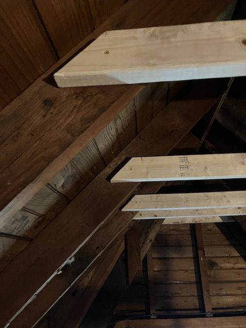

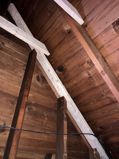

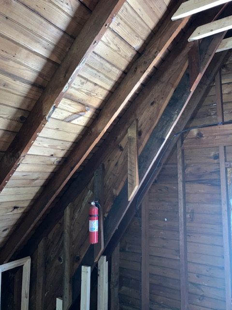

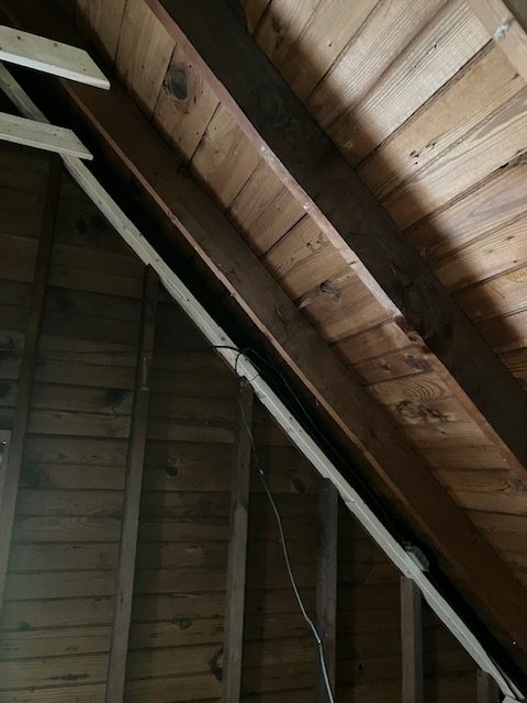

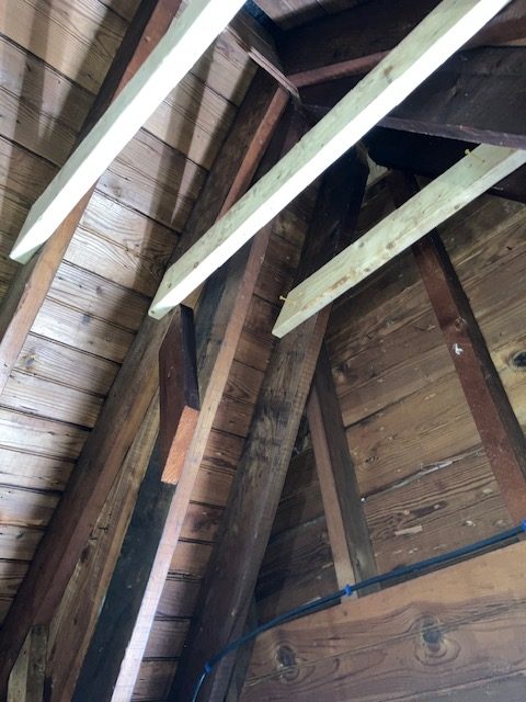

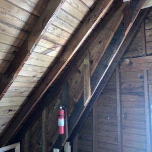

After early framing help from a capenter, I’m taking on an attic renovation. The carpenter installed knee walls at 35 inches. Because the existing 2×6″ collar ties were only halfway up the 2×6″ rafters, we removed them and installed new 2×4″ collar ties at 10 ft from the floor and 2 ft from the peak.
The current rafters are pretty bowed, so the carpenter suggested that I sister 2×8″ x 10′ planks to them, running them from the knee walls up past the collar ties on the opposite side from where we placed the collar ties. Doing this will give us a flat surface for the drywall. It will also add needed depth to the rafter cavities when we add closed cell spray foam insulation.
I’d be grateful for any reactions and for advice on the following:
1. Does this sound like a good approach? I just lugged the 2×8″ planks up three floors so fingers crossed.
2. I plan to run string lines at the bottom, middle and top of the existing rafters to get a level surface for the new rafters. Can I start the string lines at the first and last rafters, or do I need to find a place along the end walls to secure the lines? In other words, where is the best place to run my string lines?
3. What size (and brand) of fasteners should I use to sister the new rafters to the old?
4. I will likely be doing all of this on my own and assume I will need to use clamps to hold the new rafters in place while I attach them. Any suggestions on the approach here? I’ve noticed that most of the hand clamps I see are not deep enough because the new 2x8s will extend at least 2 or 3 inches past the old rafters.
Thanks in advance for any advice you all can provide here! John

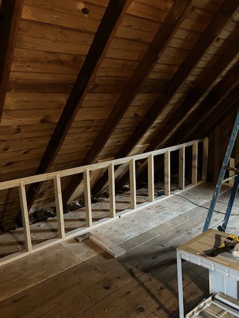

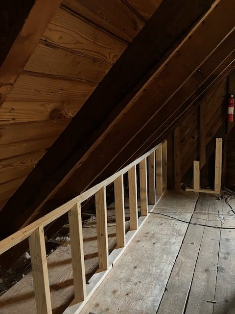

    Unless that knee wall has a bearing wall under it I would not load your knee wall like you are suggesting. You need to take your sistered rafters to your top plate.
  2. CommonwealthTudor | | #2
    Thanks for responding. I'm not actually planning to use the sister rafters for any load bearing. They will run flush up against the knee wall but not on it. The current rafters are holding up well, and are 16 inches on center, so I'm not using the new 2x8s for structural support. They are there to get create a flat surface for the drywall and to add depth for the foam insulation.
    1. freyr_design | | #5
      Malcom suggestion below is good. Even if you don’t want them to be load bearing if you sister them they will be. It will make that section of your rafters have a cross section of a 2x8 sistered to a 2x6, while the lower section will be just a 2x6. This will create a bending moment (like a hinge) at your knee wall. The plywood gusset to 2x2 is much better option.

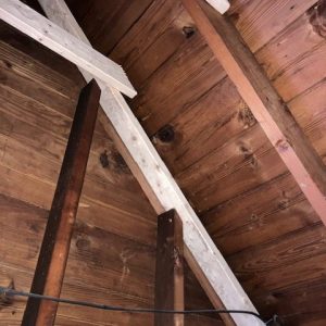

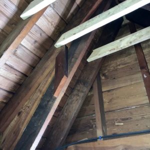

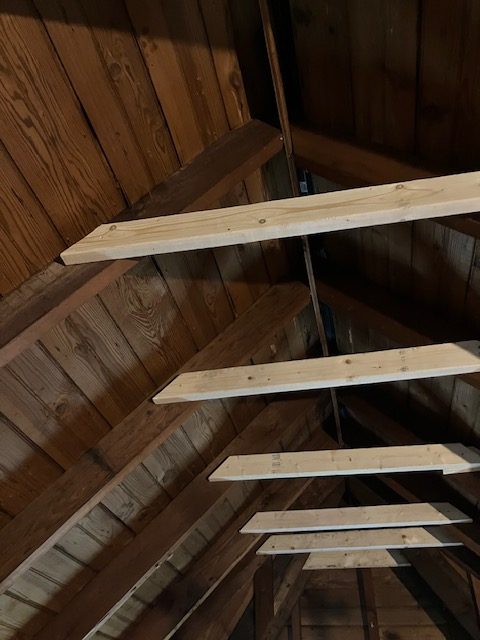

    Do you have rafter ties down under that floor in addition to the collar ties? If you do, you should be reasonably safe with your plan IF the existing rafters are sufficiently strong for snow loading in your area.
    I would not trust a single nail securing each end of those collar ties, which appears to be what you have here. I would use at least three nails in each end here, and your code likely requires 4 depending on exactly what type of nail you're using.

    If the only reasons you are doing this is to add depth to the rafter bays for more insulation, and to straighten the underside face, I'd use 2"x2"s and plywood gussets instead of the 2"x8"s. That adds very little dead-load, and greatly reduces the thermal bridging the additional 2"x8" would cause.
    I can't see from the photos, but if the first rafter isn't against the gable wall you will need to put some backing there for the drywall. I'd snap a string line and install a 2"x2" there, which you can attach the three strings across the rafters to.
    Make a hook out of metal or wood a little deeper (say 3/4" more) than the anticipated depth you are increasing the rafters by. Screw it to the 2"x6" near the collar ties to hold the 2"x2" / plywood gussets, secure the bottom of them touching the lowest string line, remove the hook and set the top, then adjust the middle.

    The question in my mind is what is under the floor and was it sized to support a live load.
    Seems unlikely the builder would spend money needlessly upsizing the attic floor on the off chance it might get finished someday.
    The other thing to look at is the stairway any existing stair will fail modern codes and is likely downright dangerous with big rises and short runs.

      Michael Maines | | #10
      Floor joists often act as rafter ties and from your photos it looks like that's what you have. If the eave walls extended above the floor then you would not have rafter ties. They are almost always undersized on older homes according to modern codes. They likely wouldn't fail catastrophically if overloaded, but they are probably already bouncy and saggy, and both would be exacerbated if you added more dead load.
      For "stringing planes", try this: get each end 2x2 exactly where you want it. Run stringlines ('mason's line" at hardware stores) very tightly from top to top and bottom to bottom of the 2x2s. The strings should be tight enough to play a low guitar note.
      Then slip in small pieces of 1-by lumber to push the string off the 2x2s and cut a few extra to keep with you. These are called gauge blocks.
      Install the next 2x2 near the center of the span. Use the gauge blocks to just "kiss" the stringline. If you don't use gauge blocks, you will get accumulated error and the wall won't be flat.
      I'd start by fastening all of the tops and bottoms of the 2x2s. Then go back and add one or two stringlines across the center of the rafter spans and use the gauge blocks to straighten each 2x2, which probably won't be very straight on their own.
      I've used this system on dozens of floors, walls and ceilings and it's pretty foolproof--as long as you use gauge blocks, and get the string as tight as humanly possible.

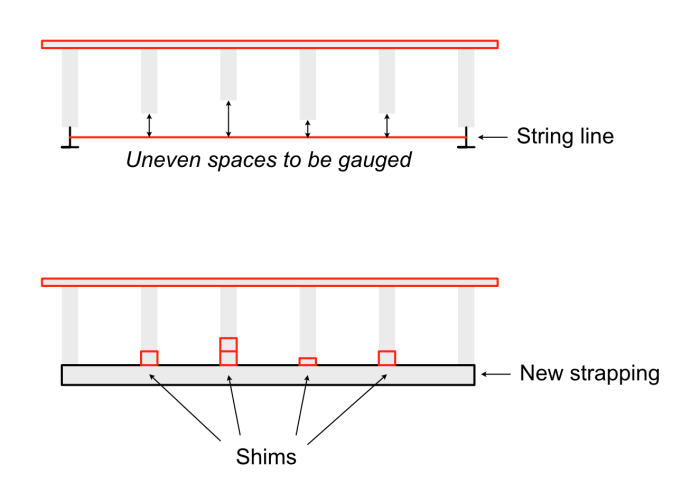

      BILL WICHERS | | #20

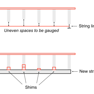

      I made a quick drawing to help show the basic idea of the stringline. There are various ways to set it up depending on what you are working with, but you are basically using the string to define a straight path across the uneven undersides of the rafters, then putting in strapping that is shimmed off of the rafters to get a flat, even surface to hang drywall from. Note that the string has to be run on the lowest rafters for my basic explanation to work, but I'm intentionally keeping it simple for the drawing.
      The same basic concept works for straightening the underside of a bowed rafter too, it just takes longer to make a drawing with curves so I showed the other case :-) The same idea still applies though: the string defines a straight line, then you use shims to even things out using the line as a reference, and put your final strapping/furring along the shims such that the new piece of wood follows the straight line of the string and not the uneven edge of the original framing.

    Thanks Bill, this diagram is very helpful! It looks like I simply need to get the lines properly strung and then fill in with 2x2s and shims to get the rafters so that they are flush with the lines to create a flat surface. Then I lay 1x4 (or perhaps 2x2s, as it will give me added depth for the form) perpendicular to the rafters and they serve as the surface for my drywall.

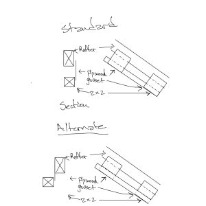

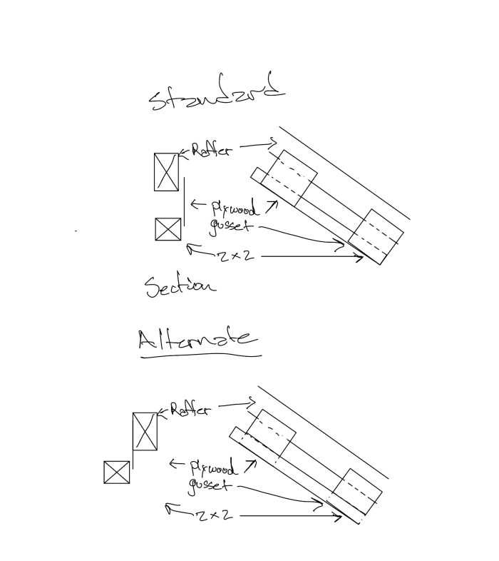

    1. freyr_design | | #25
      This is what is meant by plywood gussets

        I was thinking continuous gussets (ie 8' rips of plywood) so you'd have a straight edge for trying to get the ceiling flat. I don't think a 2x2 is going to be straight enough.
        1. freyr_design | | #29
          Oh I see I didn’t catch that. I suppose it depends on your wood quality, but I think I would just flush up the top and bottoms then run a string through center and pull out any bows. A lot less plywood. Also sorry for the double post saying same thing as Michael above, his post didn’t show up until I posted for some reason…
  10. CommonwealthTudor | | #28
    I see it, thanks! Though I have doubts about my ability to cut straight rips of plywood. Couldn't I just use continuous lengths of 1x4s along both sides of the rafters, or do they not provide the structural strength / depth I need? The insulator has told me he wants the rafters 7.5 inches deep before adding the stray foam. I do like the second drawing as the space between the 2x2s and the rafters could be filled with insulation, helping to overcome thermal bridging. If I go with plywood gussets, should I invest in a table saw in order to get straight cuts? I can find them used around here for under $100.
    1. freyr_design | | #30
      Use plywood, much less likely to split and let’s you take it up farther on rafters I would just do a gusset ever two feet or so. Depending on your wood quality, if your 2x2 is very bowed, I would snap a line/ laser on knee wall and at top on opposing rafters the gives you flush mark to land top and bottom of extensions at. Fasten those with plywood gusset, a couple of nails to 2x2 and just one to rafter. Make sure you crown you 2x2 so bow is up if it has one. Then run string line in center and pull out bow if needed and fasten plywood gusset in center. Don’t over think it too much. If you are worried it might now work or want to be able to adjust fasten those first gussets with screws
    2. paulmagnuscalabro | | #31
      If I'm correctly picturing what you're describing...
      If you run continuous 1x4s on each side of the rafter, adjusted to get you an even plane across the ceiling and more depth for foam, would mean you'd be fastening drywall to the narrower edge. They'd be much more likely to split than 2x material (ie, the 2x2s mentioned above). Also, no need to have something on both sides of the existing rafter; that's twice as much material.
      Like DC, I was also picturing continuous rips of plywood, with the plywood gussets setting your straight edge, then 2x2s fastened to the gusset for better nailing. Easier to get a consistent straight edge with plywood than regular lumber. If you're worried about maneuvering around tight areas in the house, definitely rip the material outside. Rip it outside anyway and avoid blowing all that dust in your house.

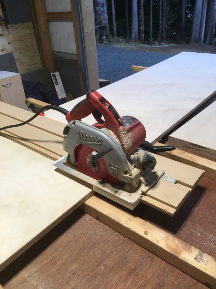

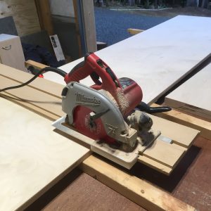

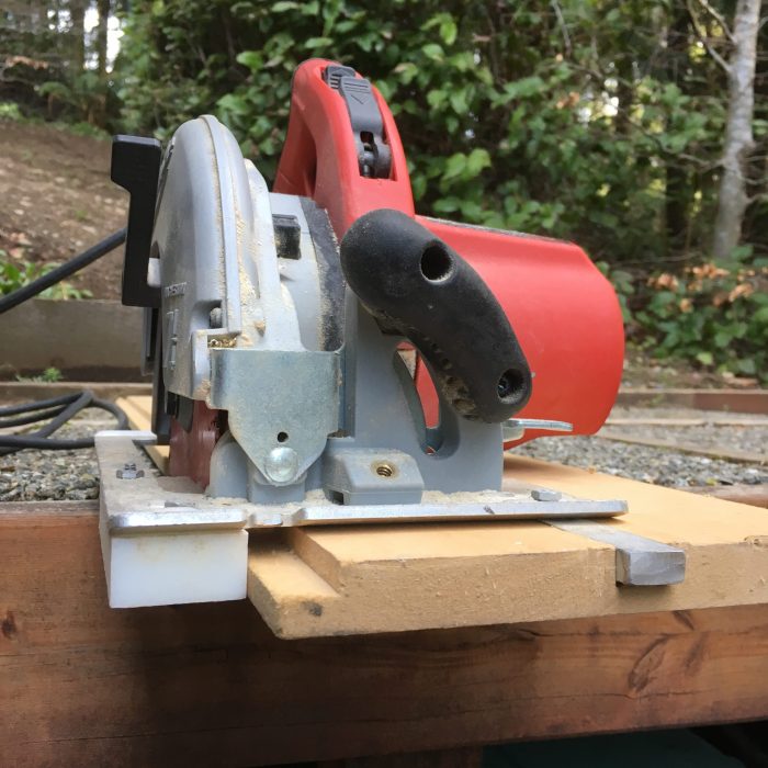

        MALCOLM TAYLOR | | #35
        Bill,
        I use a homemade track-saw for cutting down sheet goods.
          BILL WICHERS | | #41
          Pretty clever. Looks like an MDF track? What did you use to cut the grooves for the saw to ride in? Dado jig maybe? That white block looks like maybe a piece of UHMW polyethylene? Handy stuff for wear surfaces!

            DCcontrarian | | #42
            I go much simpler.
            Screw a strip of 1/2" plywood to a strip of 1/4" plywood that's wider than the base of your saw. Then run the saw down the edge of the 1/2" plywood. The 1/4" piece will now be cut precisely to a width that is the distance from the edge of the saw to the guide -- which means that edge is exactly where the cut will go. So lay the edge down on the line, clamp, and cut, no measuring.
            I liked it so much I made one with one side for my 10" saw and one side for my 7" saw.
            If I had to cut a bunch of rips all the same width I'd make a guide of that width. Then I could do them all with no measuring.
            MALCOLM TAYLOR | | #43
            Bill,
            I cut the groove with a router table. The MDF is cheap and easy to replace - although that guide is probably a decade old, so that's not a big consideration. The UHDP also reduces tear out on that side of the blade, much as the guide does on the other.

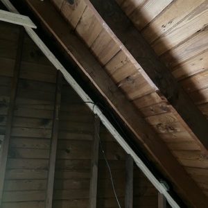

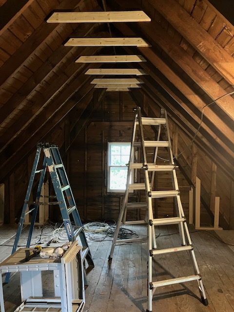

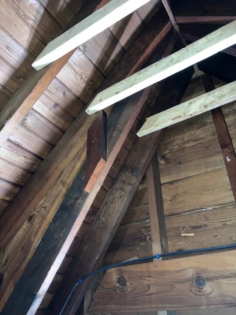

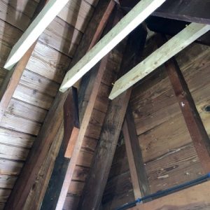

    Sorry to potentially reset the entire conversation, but another issue occurred to me last night: I have the old 2x6 collar ties which I was hoping to refinish and then reinstall after the drywall was up (and not before, given the challenge of cutting all around them). I assumed that they wouldn't really serve a supporting function but be more decorative. I was going to screw them into the edge of the 2x8s I had planned to sister to the existing rafters. Now with the gussets and 2x2s, I worry that I won't have a strong enough structure to screw the old collar ties into.
    So, this all raises this question: how vital are the gussets to this project? Can't I just use a mix of 2x2s and shims screwed directly to the edge of the existing rafter ties to get the flat surface I need, and then, if need be, run additional 2x2s (or 1x4s) perpendicular to the rafters if I'm still short on the depth I need for the spray foam? I appreciate that the gussets give me a straighter edge than the 2x2s, but using both 2x2s and then horizontal cross pieces might allow me to rely on shims to get to my flat surface.
    I've attached a photo of the old collar ties.
      MALCOLM TAYLOR | | #47
      CT,
      Yes. Almost any way you deepen and level the rafters that works for you is fine. It's basically cosmetic.
      DCcontrarian | | #48
      "Which way is less work" is one of the most loaded questions in construction.
      That said, if it were me, I'd put the drywall up before the decorative collar ties. It's hard to finish drywall around a piece of wood like that and have it look good. I'd finish the drywall, paint one coat, put up the ties, touch up the drywall where I dinged it and paint a second coat.

      1. CommonwealthTudor | | #49
        Thanks DC. I definitely plan on putting up the drywall first. I guess with long enough screws I can go through the drywall, 2x2s and foam, and into the original rafters.
        I just put up my string lines at 2 inches off of the edge of each end rafter. There are about four rafters that really sag, and where the string is only about 6.5 inches from the roof sheathing. So I think I'll need to set the strings at 4 inches and work from there. I can definitely see now how plywood gussets are the way to go as they'll provide the straight edge for the length of the rafter. Perhaps cutting the gussets into 2 ft lengths and using the 2x2s to bridge between them will help the insulation overcome thermal bridging between the rafters.
        I'm also thinking that while I may leave in the current collar ties, which are 10' off the ground, that it could make sense to install another set up them, but at 8', as this would make it easier to address the bowing (less distance to cover), and easier to install two even rows of horizontal drywall.

  15. maine_tyler | | #51
    I agree with Michael, this has gotten kinda twisted and over complicated.
    There's no need to have long runs of plywood (and plywood aint' cheap these days). You just want a 2x2 with rectangles of plywood (i.e. gussets) screwed to the side of the 2x2, which then screws to the side of the old rafters (as freyr design shows in post #25).
    You can set these assemblies at the exact height you need. No fussing with shims. This talk of shimming furring strips has muddied the waters. Just treat these gusseted 2x2 assemblies like you would have the 2x8's as you originally proposed. The only difference is that you are screwing through plywood (e.g. 1/2" plywood) instead of the 1.5" of a 2x8.
    You can set these to any depth you want (see DC's post #45 about insulation R value), limited only by the length of the gusset. If you go deep enough, you can always upgrade to 2x4 for added rigidity.
    You can then screw your decorative ties, or any other wall hangings, into these 2x2's.
    It's a bit like the truss system shown here (first image): https://riversonghousewright.wordpress.com/about/26-evolution-of-the-riversong-truss-system/

    2. CommonwealthTudor | | #56
      Thanks Tyler! My plan is to space 2ft lengths of plywood as my gussets, with 2ft spans in between where the 2x2s will run. So a gusset at the bottom, middle, and top of the rafter, all joined by 2x2s running the length of the rafter, as shown in Freyr's design.

  17. CommonwealthTudor | | #57
    I hope I haven't worn out my welcome after all this helpful feedback, but I've run my string lines and I'm wondering why I can't just cut my existing 2x8s into one-foot lengths that I then sister to the existing rafters. After that, I would run 1x4s perpendicularly to the rafters to get the flat surface for my drywall. I sense that the three one-foot lengths of 2x8 won't add too much weight to the rafters and would be a lot easier than creating plywood gussets connected by 2x2s. Plus, I have this big pile of 2x8s that I could put to use. Any strong concerns about this approach? Thanks in advance for any feedback. John
      DCcontrarian | | #58
      Lots of ways to skin this cat. That'll work.
      1. CommonwealthTudor | | #59
        Thanks!

  18. CommonwealthTudor | | #61
    Hi everyone, just a quick update and also wanted to send my appreciation. I spent the week installing gussets per the design you all recommended, though using 2x3s as they seemed sturdier. The first picture shows one whole wall finished. Because the original collar ties were higher than I wanted, I'll be installing new ones shortly that cross over where the 2x3 ends.
    Now for the next challenge: there are stairs leading up to the attic and a dormer window at the landing. I've added gussets to the rafters closest to the opening, but as you can see, I need to deal with adding gussets to the rafters above the opening. Clearly I can do so, but then I worry that the bottom end of the gusset will hang below the current opening, creating problems for adding drywall later to the peak of the dormer.
    Thanks for any advice on how to tackle this next stage of the project.
