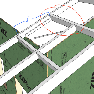

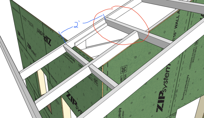

    I'm further along with the design and have run into an issue. The truss blocking up slope will block the vent channels. I seem to need that blocking so as to have nailing surfaces for the roof sheathing.
    That makes me wonder if I can skip the soffit vents altogether and simply use a full-length ridge vent along with gable vents? The roof is only 5/12 and 12' x 16'.
    I'm using boxed eaves, air sealing the ceiling with Contega HF in the joints and MemBrain across the span. I'm using batt insulation in the attic (which also makes me wonder if baffles are needed anyway - does batt insulation suffer from wind washing?).

      Practically you can probably get away with a combination of ridge and gable vents, although it doesn't meet code. Can you post a drawing of the truss blocking? Your description of it being necessary as a nailing surface is unusual.

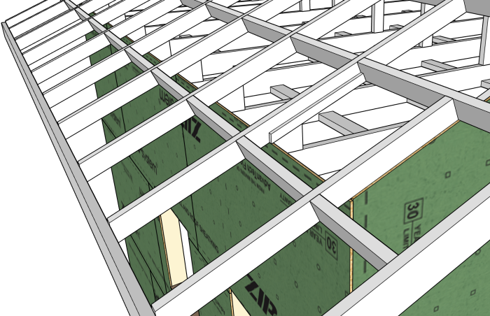

    Drawing attached. I hid quite a few elements to make the issue cleared.

      Isn't that blocking on the outriggers above the level of your batts in the attic.
  7. Tiziano | | #17
    For that first one, just barely. So if I run the baffles along that furring strip I'd have to keep the baffles quite short.

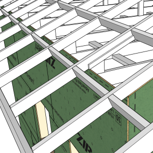

    Plus, I've got blocking across all the trusses, in rows all the way up separated 2 ft oc for sheathing nailing. I'm thinking it's overkill and all I need is blocking at the ridge and the tops of the bottom chords.
    1. Malcolm_Taylor | | #18
      Tiziano,
      The only blocking you need is that called out on the truss drawings.
      1. Tiziano | | #19
        They only show the common and end trusses - no connections or how it all fits together.
        Pages 2 and 3 of the attached.
        1. Malcolm_Taylor | | #20
          Tiziano,
          There is nothing to fit together. You stand the trusses, frame the lookouts, put on a rough fascia, and sheath the roof. No blocking, and the only bracing required is one on the bottom chord if you weren't putting in a ceiling.
