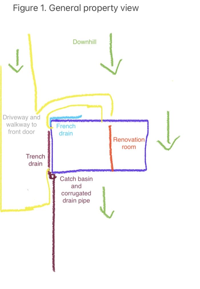

Background: 1974 split level ranch built on the side of a hill. Climate zone 5A. Recently replaced gutters & downspouts. ~25 year old French drain servicing about 1/3 of the uphill facing side of home. Got a borescope to inspect the french drain and the underground drain pipes that 3 of the 4 downspouts are attached to. Most of what I can seen looks unclogged but much of the system is unreachable as the borescope is like pushing a chain. However, I ran a hose in the drain pipes and got flow out the other ends so while they may have leaks, I know they at least work somewhat. Last fall I installed a trench drain in front of the garage and tied it into a catch basin under the only downspout that wasn’t attached to underground drainage, then ran 50’ of corrugated drain pipe downhill to daylight. I intend to put a curtain drain spanning the entire uphill facing side of the house this spring because I know step 1 when finishing a basement is to control water and that battle is largely outside.
Figure 1. General property view

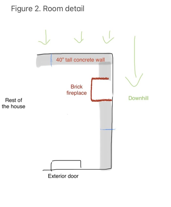

I am renovating a walkout “basement” (in quotes because I think since the most below grade wall is less than 50% below grade, code doesn’t consider it a basement?). On two sides of the room there is a 40” tall concrete (stem?) wall that had 16”oc 2×4 framing with fiberglass insulation in some stud bays and what appeared to be ~1” thick styrofoam boards cobbled on top of one another (not taped and not continuous or behind the studs/between the studs & concrete wall) in other stud bays. There was a poly sheet stapled to the interior side of the framing, then drywall, and then wood paneling. There was extensive mold and water damage and I discovered a couple vertical cracks in the concrete wall (Fig. 2 indicated in blue). The damage was undoubtedly made worse because the drywall was run all the way down to the concrete slab and the wood paneling hid the mold. I removed all of the moldy drywall and rotten wood last spring and sealed the cracks with an epoxy injection kit and have not seen any bulk water intrusion since. I also recently taped some 1’x1’ plastic sheets to a few places on the concrete walls to test for moisture and have not seen any but I’m not sure if that test needs to be done in the summer. I ran a dehumidifier in the room last summer and collected around 8 gallons of water a day on average (350sqft room).
Figure 2. Room detail
My question is what wall assembly would be best when I rebuild?

    BILL WICHERS | | #1
    Any batt insulating product, including rockwool, should not be used in contact with a below grade masonry wall. Moisture will accumulate within the batt and that's where you'll get mold problems.
    CONCRETE WALLS DO NOT NEED TO BREATHE. THEY DO NOT NEED TO "DRY" AT ALL.
    Read that again. Concrete can stay wet forever without any problems. It is the INSULATING MATERIAL that introduces the potential for mold to GROW WITHIN THE MATERIAL here. THAT is what you need to avoid. Rigid foam is an air barrier, so no issues with mold growing inside, and no issues with bulk water. If the rigid foam is installed tight to the basement wall, there isn't really a place for mold to do much anyway, and if you seal the rigid foam to the wall around the perimeter, any mold would be encapsulated and wouldn't be a problem.
    If you don't have bulk water problems, I'd insulate with polyiso. If you do have bulk water problems, then I'd insulate with EPS. EPS will need a thermal barrier, which is usually drywall, but can also be 1/4" hardboard, plywood, or other approved barrier. If you use polyiso, you can use something like Dow Thermax that has one side rated to be left exposed, which negates the need for a thermal barrier.
    Again, do NOT use batts here. Batts WILL be a mold problem eventually. Don't worry about the concerte "drying", that is NOT an issue -- you can seal it up and not worry about it.
