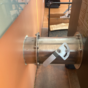

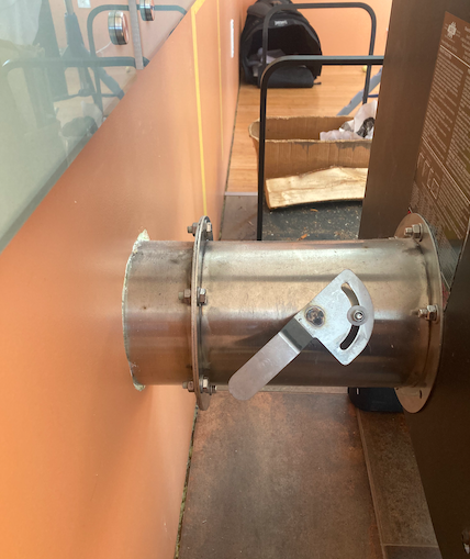

  4. user_8675309 | | #8
    I am very familiar with this subject. I have a tight house(4" exterior insulation, remote wall configuration), in Anchorage Alaska where it certainly can be cold, and primarily heat my upstairs with a Scan wood stove all winter. 1500 square foot house, HRV installed with 5 supplies and 3 exhausts. 2 bath fans that exhaust to the outside. The wood stove was set up with a 4" proximity air supply that terminated at the back of the stove. I only had backdraft issues when running a fan while trying to start a fire or when the fire was not very hot. During my latest phase of remodeling I added a range hood that exhausts outside (sub 400 cfm)and knew I might have more problems, so I bumped up the fresh air duct to 6" (stainless steel, has an adjustable damper). Has it cured all problems? I can't say for sure as I have not hooked up my range yet, but I feel better having the ability to have a bit more air available. BTW, having fresh air terminate at/near the wood stove is awesome - when running a bath fan I can feel the cold air coming in but only if I am within a foot of the stove. My version of pre-heating cold fresh air.
