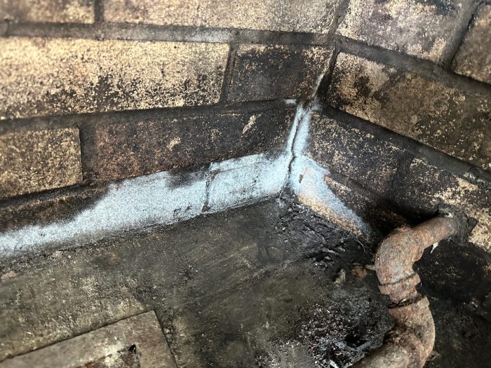

I live in the Cleveland area. I have a brick fireplace that was converted to gas. I’ve been in the home (1992 build) for 5 years and I have never used it. It’s drafty, so I put mineral wool insulation in the ceiling of the firebox, covering the damper.  Some improvement, but when I recently looked inside, I discovered snow and ice on walls and floor (see pic). The ash pit was dry. I plan on cleaning and de-icing the firebox and then applying a sealant. I have to figure out how the moisture is getting in (I suspect cracked caulking). In the meantime, I plan on re-insulating the interior of the fireplace. Place 2” XPS rigid foam board in the firebox on the ceiling against the damper, the 3 walls, and on the floor, which will also cover the deteriorating lid of the ash pit. I will use closed cell spray foam to fill gaps between boards to create an air barrier. I will then fill the firebox with mineral wool insulation.  Finally, I will follow Mike Guertin’s recommendation to “clearly label the firebox as non-functioning so that someone now or in the future doesn’t try to start a fire there.”
Any recommendations for a sealant? Does this insulating strategy (air barrier) make sense?  Thank you.
