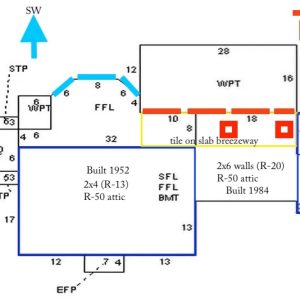

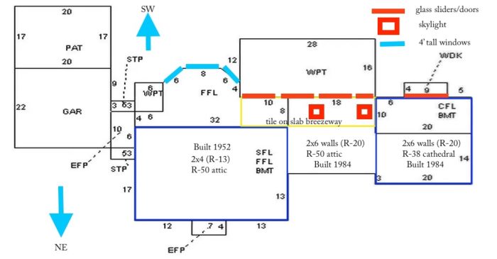

      Thanks for your reply. The original house is a 1950s stick construction (2x4) shed-dormered gambrel, ~1600sqft with original single pane windows with storms (every window has cellular shades). A 1980s addition added two staggered gambrel sections (2x6 stick), so 70' long in total. Long side faces the SW, with ~50% of walls comprised of windows/siding doors. See the attached drawing. Since moving in I've improved the envelope by extensively air sealing, bringing the 1950s attic up to ~R50, 1.5" polyiso on the basement walls, replacing four SW-oriented sliding doors with high SHGC Marvin units in our sun room which helped a lot.
      Good point about the partial loads with a larger boiler. I will look into this. If a Weil Mclain ecotech 150 modulate down to 10:1, I wouldn't lose much compared to the ecotech 110 yet still have top end for the rare -10ºF night we get every few years.
