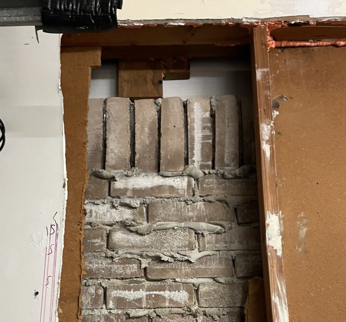

Hi, climate 2 , brick veneer exterior home. I’m replacing wall in my garage , I noticed the  brick joints are missing mortar in many of joints , should I fill them in with mortar or not ? Or will it cause problems if I do like moisture  buildup ? Thanks

    That looks like the backside of the brick. That is how it typically looks. A bit too much mortar in some areas squished through, a bit shy in other areas. If the photo os the backside (the side you would typically never see, this is normal and not a cause for concern.

      It is the back side . And oh ok I just thought it was an ugly case of mortar . Would it hurt to fill them in for reducing any drafts that carry moisture and for stronger structural exterior walls?

        If it's just brick veneer, it won't make much difference but won't hurt anything.
        You are aware that you need to keep any metal brick ties in place, right? And the lateral bracing that the wood fiberboard provides?

    The gaps should only be backside gaps; the mortar on the front side should be continuous.
    As such, there should not be any opportunity for bulk water or air to come through the brick.
    Also, the brick should not be your air barrier...so filling the backside gaps will not address the issues you noted.
    Further, in order to do so, you are going to need to remove the sheathing, and that is a very poor idea. The brick ties should be attached at the studs, and as Michael notes, they should not be removed. But there is clear evidence there is a cut tie in the upper left of your photo. That is going to destabalize the brick.
    In this install, the brick is your bulk water barrier, but a brick/mortar system is moisture permeable, so when it gets sopping wet, water can migrate through it to the back side. You do NOT want to lock moisture into the brick.
    The space between the back of the brick and the sheathing is your "rain screen" gap. It allows any stray bulk water that gets past the brick and mortar to run down the wall and hopefully out at the bottom. The brick wall should have weeps at the bottom that let this water out.

    You noted you want to stop moisture migration but don't want to remove either the brick or the siding at the gable ends. In that case, leave the sheathing alone.
    One possibility given your constraints is that you could remove the gyp board from the inside, and do a "cut & cobble" in each stud bay of 1/2" or more rigid insulation, and seal it all around to the studs. This would get you both an air and vapor barrier. You could also seal all jboxes and other penetrations. Then reinstall the fiberglass (you could probably learn to do a MUCH better job than a typical insulation contractor, but fiberglass is nasty; wear PPE). Then reinstall all the interior gyp board. This is a relatively inefficient way to get an air and vapor barrier as it is labor intensive to do a proper job. It is also messy inside, which is why most people approach the issue from the exterior.

    My reasoning for wanting to fill in the brick joints was because on the outside of the brick wall the mortar seems to get cracks and holes and u fill them in and they reappear after a few months . I removed the fiberboard because it was damp and I was able to take it apart with my hand since it crumbled in some areas . I’m going to replace with osb . Just that section of the wall . I probably won’t attempt to do the whole wall on my own . I’m going to focus on the air leaks, but with a non-condition garage and attic that is vented., Any advice where not to seal? I don’t want to trap moisture in . It’s just kind of confusing because I’ve been told by some to let the wall breathe ,

      If there is an issue at the exterior with the mortar, then it may need repointing. Adding mortar from the back side is not going to fix that issue.
      If the fiberboard was damp and crumbled, it sounds like bulk water is getting behind the brick. At the area where the fiberboard was damp, what is above the brick wall? Is this at a gable end with the Hardie siding above it? It could be the top of the brick was not properly flashed before the Hardie was installed, and that would allow bulk water behind the brick. Given your siding installer did not insist on installing sheathing onto the framing behind the siding, there may be other gaps in their knowledge.
      It is going to be difficult to replace that section with OSB - you will have to cut the OSB the width of the stud bay, then attach nailers to the inside of the OSB, then slide it in and attach the nailers to the sides of the studs. I'd consider replacing with rigid insulation (cut & cobble method). That will at least keep moisture out of that stud bay.
