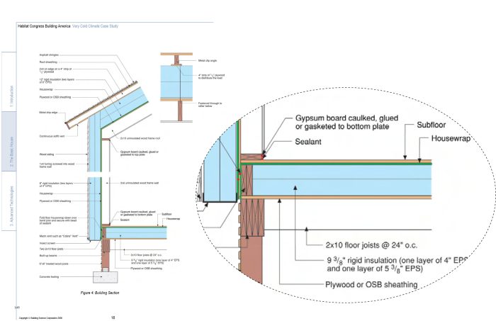

I am following, generally for wall assembly/strategy, the BSC Very Cold Case Study House for Juneau, AK (Part of Building America). My house will sit on concrete fin walls up above exposed ledge (open air between ledge and floor joists).
BSC Case Study Link:
https://buildingscience.com/documents/houseplans/hp-very-cold-recommendations/view
BSC House Plan Set Link:
https://buildingscience.com/documents/houseplans/hp-juneau-ak-example/view
Main Question:

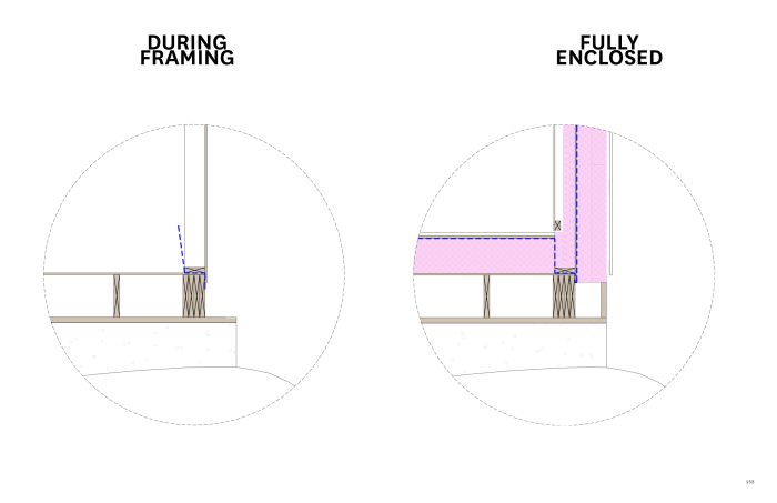

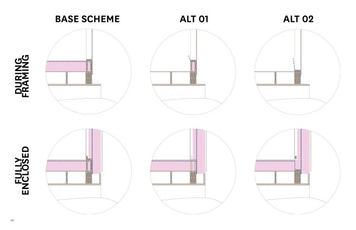

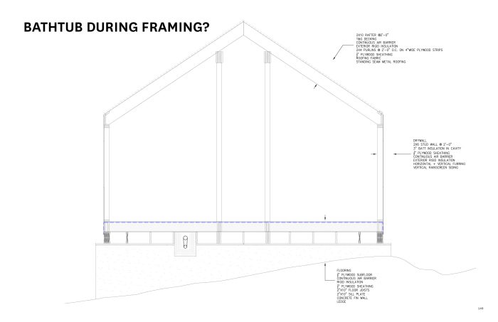

In the case study house, the floor insulation is sandwiched between sheathing with the air barrier underneath the upper sheathing. The exterior walls are then built on top of this floor assembly. During framing, until it’s dried in, I worry that this assembly becomes something of a bathtub. The seams of the upper sheathing are going to let rain water down to pool on top of the air barrier which will almost certainly find its way through the edges of hundreds of screw perforations into the insulation cavity. I’m solo building this, so the framing process will be longer than normal.
1) Does anyone know if this case study house was ever built? I can’t find anything except the report and plans online.
2) Base Detail: Am I over-thinking this water penetration worry during framing? I don’t think of this as a simple “my subfloor got wet” concern, but I’m new to this.

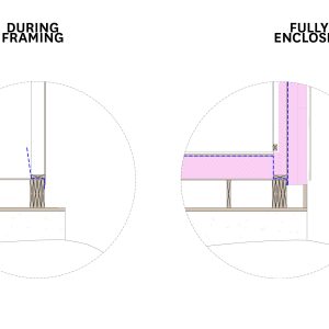

3) Alternative Detail 01: I could build the rim-board section, run a strip of air barrier (to be lapped/taped later to the future floor and wall barrier) and build the exterior walls on top of it. This would leave the insulation, floor air barrier, and top floor sheathing until after the house is dried in. It makes sequencing and framing tilt up more complicated but keeps the air barrier and insulation in the same location and negates my bathtub worry. This is my leading strategy as of now, despite its added complication.
4) Alternative Detail 02: Frame the wall studs directly on the bottom layer of sheathing with a strip of air barrier underneath (to be lapped/taped to future floor and wall barrier). This is the strongest and simplest framing strategy. But it creates a pocket of insulation inside the air barrier instead of keeping the insulation on the exterior. Is that just begging for interior condensation and eventual rot?

    You could use something like this to help protect
    https://proclima.com/products/external-sealing/solitex-adhero-visto
    1. az_la | | #2
      Since there is a air tight / vapor diffusion-open membrane underneath the plywood, would this weathering-protection membrane need to get scraped off of the top when the framing was dried in? or left in place with membranes on each side of the plywood?
      1. freyr_design | | #3
        While I’ve never used it I believe it is designed to be temporary and so should be reasonably easy to remove. That being said I might be tempted to simply use that as my air barrier. If you reach out to 475 supply they will be able to give you guidance on that product characteristics as they are the us supplier of pro clima.

            I would not do alternate 1 for the sake of construction. I would consider option 2. You could minimize the risk by just taping your seams on the top layer of ply or insul, but I would still want to do something to minimize water on your bottom layer during construction, so I don’t see much benefit. Also keep in mind, plywood is vapor permeable and a floor is much more forgiving than a roof, you will not have the same drive for interior vapor to condense on your floor.

    Would appreciate any other input on the Option 2 detail where the air barrier is on the outside of the insulation at the bottom of the stud bay and potential condensation / moisture complications long run.
