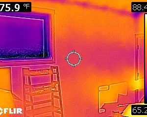

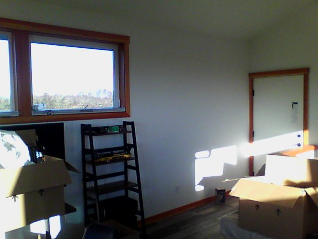

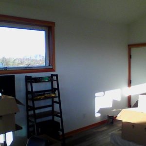

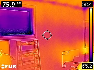

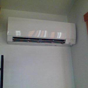

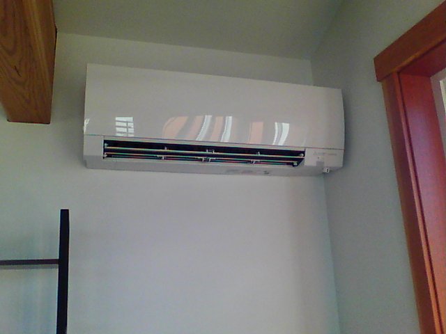

  6. bob111 | | #13

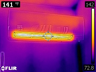

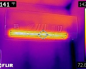

    Here are some pictures of my office indoor unit on Feb 11 that illustrate the improper operation of a cross-wired system. The indoor unit is outputting air at 141 deg F causing the room temperature to be approximately 76 deg F even though the remote control setpoint was 63 deg F. The hot refrigerant was being sent to the office due to the cross-wire mistake and the exercise room calling for heat. The exercise room setpoint was 66 deg F and it's room temperature was approximately 57 deg F so heat was being commanded but it was all going to the office which was significantly overheated. This type of operation stresses the system and can prematurely cause component failures.
      BILL WICHERS | | #15
      141*F is not hot enough to cause failure of the coil materials. If you were seeing temperature-related failures, I'd expect those to show up in the electronics and possibly plastic materials of the unit, not the coil and refrigeration tubing. As an example, if I go solder a copper wire, I usually set my soldering iron around 600-700*F. This is hot enough to melt and flow the solder, but it does absolutely nothing to the copper in the wire I'm soldering -- it's not even hot enough to cause discoloration of the copper wire.
      1. bob111 | | #17
        Hi Bill,
        Thanks for your reply. I'm not trying to say that 141 degF is too hot, just that the system is essentially running in an open loop mode rather than as a normal closed loop system using feedback from temperature sensors to turn off the heat when the setpoint temp is reached. During cross wired operation the system may work harder than it would normally and that can stress components. I believe the evap coil leak may have been caused by excessive freeze/thaw cycling last summer when the system was in cooling mode and it may haven't gotten worse as the refrigerant leaked out of the system. For most of the summer, no one was in the rooms affected by the cross wiring error and it was September before I noticed the system wasn't working properly and there was a flashing error code. I don't have any data from last summer/fall so I showed some recent data after the leak was repaired but before the cross wiring error was fixed.

          BILL WICHERS | | #18
          The system should be able to run open loop continuously without problems. These systems are built to be able to run long operating cycles, so running for hours on end shouldn't be a problem. I doubt that's the issue here.
