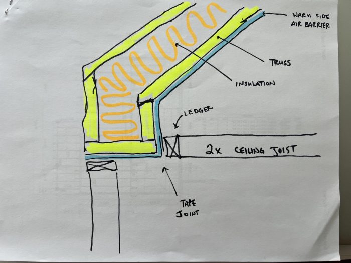

      Given that this assembly is cathedral ceiling adjacent, am I correct in thinking that we need to install a vapor control layer such as Intello on the underside of the insulation? This would allow for blown-in insulation, but may require some accommodation in our roof framing/truss design.

        That is kind of the crux of my most recent question - I couldn't easily wrap my head around how to get away from foam without framing it like a cathedral ceiling and providing an interior vapor control layer directly below the insulation. I've done cathedrals this way on a couple occasions with ridge beams, but I am not sure there would be any advantage or cost savings in this scenario given that the attic will be mechanical space and we will have a flat ceiling below.
        I think I may be able to discuss some options with my truss designer to provide a tray ceiling type truss that transitions into a scissor/sloped truss - think room-in truss with really short knee walls, extra depth along below the top chord to accommodate R-49 fluffy stuff, and no central bottom chord. If I can drape an air-barrier over my top plate, I could then connect it to a warm side air barrier on the bottom side of the truss. On the interior of the air barrier, we could ledger perpendicular to the truss and install ceiling joist in place of a typical bottom chord. Extra framing, but nothing our crews haven't done before.
        Or, we could just use open cell foam and an intumescent coating, which may be more practical and cost effective.

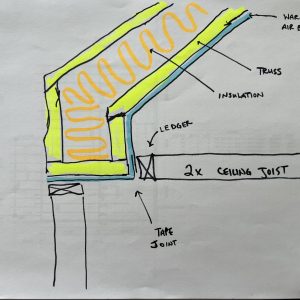

          Akos | | #12
          I think you are on the right track. I would modify it slightly by starting with essentially a raised heel scissor truss shape and add a collar tie to it. Essentially building a room truss with low ceiling and sloped walls so it can all be insulted with loose fill.
          You can sheath the inside of this space including the floor with zip with taped seams which becomes the air barrier.
          If you select the inner slope of the truss to be 4:12 or less you can now loose fill the attic space for low cost insulation.
          No spray foam and no extra roof deck. The inner ZIP does add a bit of labor but if you can limit the size of the space (ie add a tie up high to the truss to reduce room height or change the width of the inner room), it won't be all that much.
          You will have to add blocking at the bottom between the truss members for air barrier continuity down to the ceiling bellow.
          1. Nat_Elliston | | #13
            Akos,
            I like that thought, but may use a membrane for the air barrier instead of zip, and just construct a catwalk for servicing mechanicals instead of flooring the entire attic floor. I will keep iterating and discuss options with my truss designer. Thanks for the input,

            Akos | | #14
            Nat,
            The reason I suggested ZIP is that it can be done by the framers. This means after rough framing you have the attic space ready for the HVAC install. Might be a bit more cost up front but saves on staging as a single trade can handle the prep.
            The floor doesn't need full coverage nor does it need to be taped. The blocking at the bottom does need to be well sealed though so that is where I would focus your effort.
        Michael Maines | | #10
        Nat and Malcolm, yes, sorry, I should have mentioned that--by code any air-permeable insulation installed in a moderate or cold climate needs an air barrier on the interior side.
        If your roof trusses will have a lot of webs in the way, getting the interior air control layer actually airtight can be pretty challenging. It's possible, but it takes effort. Open cell foam expands enough to fill in around the webs, though the installer does need to pay attention to avoid air bypasses.
        Vapor control is separate from air control. I've heard Dr. Joe say more than once that although building codes allow open-cell foam in roofs because it's not air-permeable, the fact that it's vapor-permeable means that in cold climates moisture will migrate through. I believe upcoming codes will be updated with that information.
