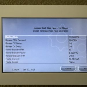

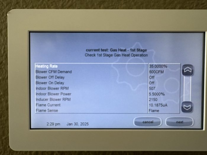

I have a Lennox SLP98UH090XV60C-04 98% furnace that is about 13 years old. I am trying to measure BTU/hr using CFM airflow and heat rise so I know how big of a heat pump to replace it with. But before I can calculate it I need to measure the static pressure to find the airflow so I got my manual out but I could not find the typical airflow/static pressure table for this model.

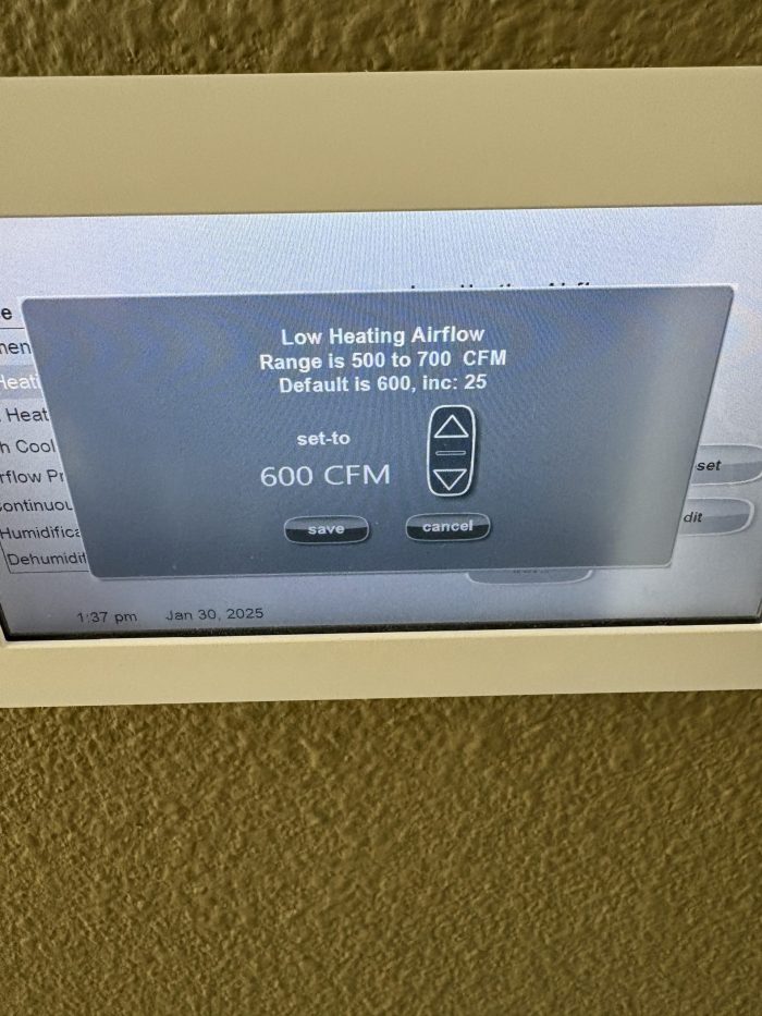

However within my Lennox IComfort display for the furnace I found this screen, as you can see that at 35% heating (lowest) it shows a default of 600CFM. Not trusting the screen, I ran a quick test and I watched the RPM of the motor at 35% heating change when I removed my air filter, so my thought was this blower motor will maintain that 600CFM as long as the static pressure is not above 1.0 (what the manual says, in heating mode my total static pressure is well below that.)
Can I trust this 600CFM number for my heat rise formula?
600CFM X 1.08 factor X 56.7F heat rise = 36,742 BTU/hr at 0F outside (design temp in Boulder)

    My guess is the CFM number the thermostat displays is approximation based in the frequency voltage and current the motor is using. Not sure I would select new equipment based on that number.

    I have run a calculation from your link you provided and I get 32,828 BTUh. This is close to the 36,742 BTUh heat rise calculation I did, and the 39,855 BTUh gas meter reading calculation I also did. My furnace rated output is 87,000 BTUh, 35% of that is 30,450 BTUh.
    Walta100: one option would be to keep the furnace and just add a heat pump to it, I would keep using the blower until it dies. It is 13 years old, running at a 1.01 static pressure in summer not sure how much it will last?
    I have to think that Lennox spent millions are R&D on this furnace, since they know the exact RPM and the exact power going to the blower they know the exact airflow running through their cabinet which they can display the CFM on the display screen with confidence.
