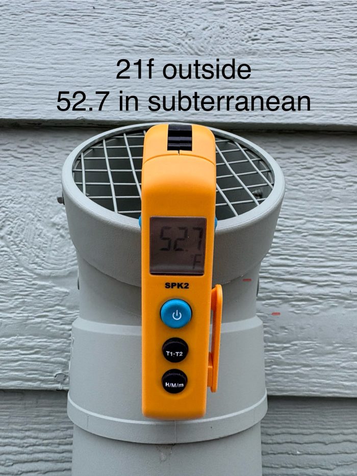

I have radon in my house, my radon fan runs all year long to keep the radon at safe levels. The air that comes out of my radon system exhaust is 52.7F at 40% RH in the winter. The exhaust is 4″ in diameter and the airspeed is 1,300 Ft/min which if I am calculating that correctly is 113 CFM.
My radon fan location is close to where I would locate my new heat pump. What if I changed the radon exhaust to blow into the air input side of the heat pump?

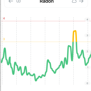

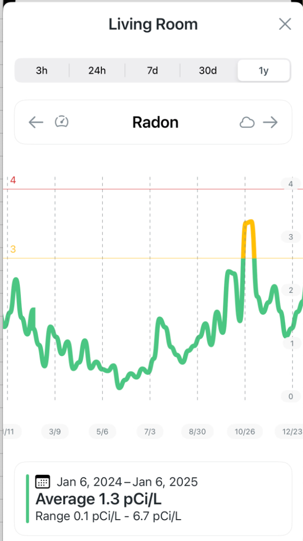

    Akos, I do not have a normal basement, because of our soil I have a wooden basement floor, below the wooden floor I have a few feet of air, that is where the radon system is pulling from (at the sump pit).
    As you can see in the graph my radon system keeps my radon to a safe 1.3 pCi/L over the past year. In the summer I only run it 6 hours a day, but in the winter my testing shows I need to keep it at 113CFM 24/7.
    Getting back to my idea, I might give it a try when I get my new heat pump.
