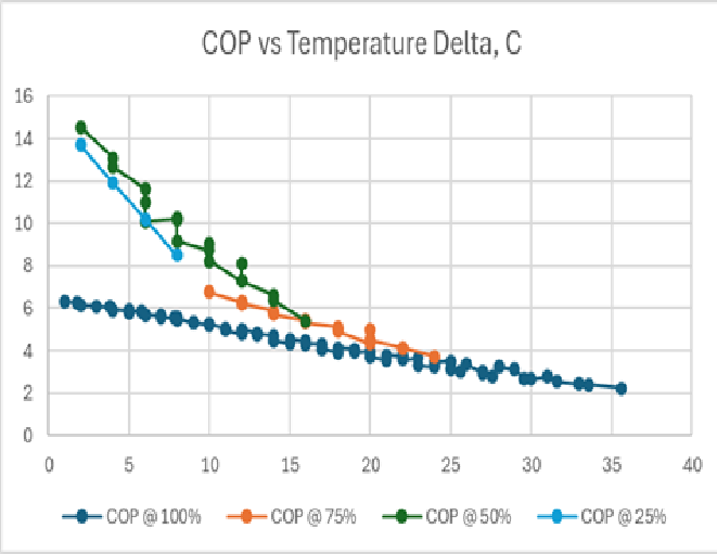

    DCcontrarian | | #22
    In the Boston climate you should be able to get an average COP of close to 3.
    I've attached a graph of COP vs temperature delta for the Chiltrix CX34. The delta is between outdoor temperature and water temperature (in C). There are four lines, for 100%, 75%, 50% and 25% of load. As you can see, the key to high COP is to keep the delta as small as possible and to keep the load as small as possible (although there isn't much difference between 50% and 25%, it's kind of hard to tell because they only gave four data points. ) A heat pump is going to be much happier running continuously at a small delta and a low output than running sporadically at high delta and full output.
    A heat pump is going to work best with emitters -- the things that put out the heat, like radiators, fan coil units and underfloor heat -- that are able to modulate their output to meet the heating load. If you have active emitters, like fan coil units, you can modulate by changing the fan speed. With passive emitters (radiators, underfloor heat) you can either modulate the flow -- variable speed pumps, thermostatic valves or zone valves -- or you can modulate the temperature.
    Like most air-to-water heat pumps, the Chiltrix has built-in outdoor reset, where the user can program in a curve to adjust the water temperature depending on the outside temperature. That allows you to have lower deltas at lower loads, raising the COP further.
    If the emitters can modulate, then the heat pump can detect how much heat they emitting, and match its output exactly to that. Combined with a well-programmed outdoor reset, you get the optimal COP at all load conditions.
    All of this is preamble to my main point, which is that I'm skeptical of the heat exchanger setup, because it takes away the heat pump's ability to detect the actual load. So you lose the ability to modulate the output, which puts a major hit on COP.
    In general, heated floors are a good match for heat pumps, in some cases they can be plumbed direct-to-load, with no external circulators or buffer tanks.
    My personal feeling is the biggest mistake you can make is to over-complicate the setup.
