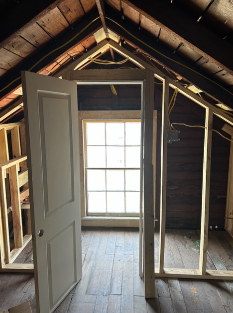

We are converting the attic into a conditioned third bedroom with a powder bath and I’m looking for insulation advice.

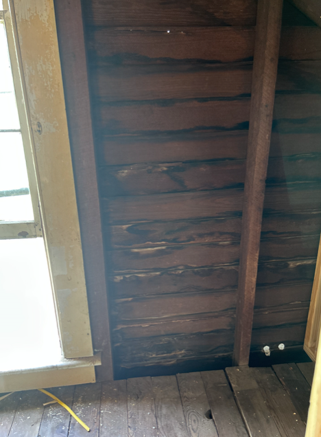

When we purchased the house, it had old fiberglass batt between the floor joists and an old door with a pulley covering the stairs leading up to the attic. This and all the old batt have been removed as well as the old wiring, etc. in the first picture.
With the exception of air gaps in the siding there was no attic ventilation. We recently had a new roof installed. There are now 2 Air Hawks on the East side. My wife shot down Air Hawks on the West side due to aesthetics.

The rafters, knee walls, and North / South walls will have drywall.
Regarding the rafters … they look bigger but are 2×4… and I know there’s no way to get max R-value against the roof due to dimensions.

Regarding North / South exterior walls … you can see that wind driven rain has been blown in over the past 139 years … and due to the spacing / cavity the cypress siding just dries out with no signs of rot / mold. I’m hesitant to fill the entire cavity with insulation.
