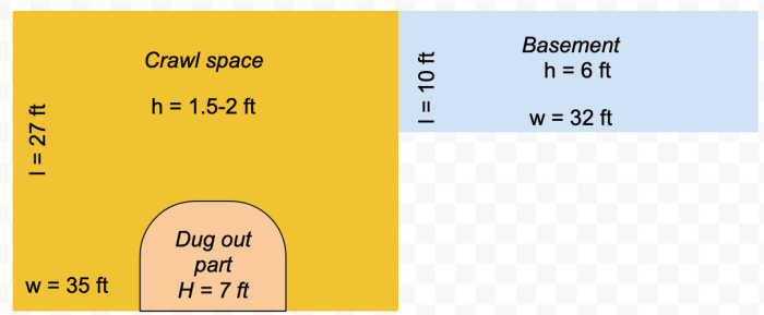

I’m looking for advice on how to condition my crawl space and basement given my unique situation. I’m in zone 4a.
## Context

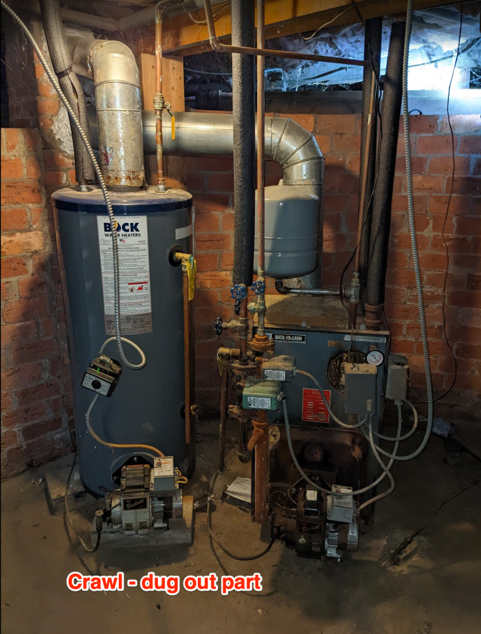

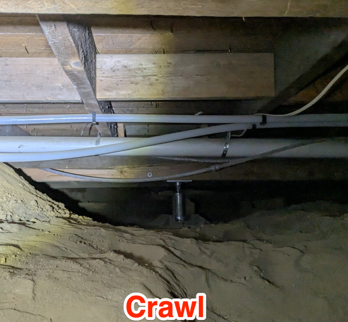

The main structure sits above a dirt crawl space with a 1.5 ft clearance. I plan to put a vapor barrier (poly) on the dirt. A 5th of it is dug out—with a concrete floor—to accommodate appliances. See attached pictures.
An extension that has about half the footprint has a basement instead of a crawl. The basement and crawl are somewhat connected.
I had originally planned to keep the crawl space and basement vented and unconditioned because that’s how it had been for a century (not without issues, though). I was planning to insulate the floors above those areas with batt insulation in the floor bays and then rigid foam board across the joists, taped at the seams to create an air seal. I conducted my manual Js and Ds according to this original plan, meaning I did not account for the crawl and basement loads. I had two slim ducted heat pumps installed in conditioned areas in drop-ceilings in the house: 1 for the 1st floor above the crawl and 1 for the extension above the basement. They were intentionally not oversized to maximize performance. They’re my only heating and cooling source, no backup.

What strategy would you recommend for conditioning my crawl space and basement if they’re encapsulated?
Here are some options I can think of, which is best? Is there a better one?
a) Don’t bother with heating and cooling. Once encapsulation is done, the basement and crawl loads will be trivial. Maybe open some vents in the floors to get some warm air in there and just run a dehumidifier in warmer seasons. (I’m worried that my heat pumps don’t have enough capacity for this strategy).
b) Set up a propane heating solution in the crawl or cellar and duct it to both areas. (No gas infrastructure available). This will only solve heating, but it would provide a backup if the heat pumps can’t keep up during the coldest days. Run a dehumidifier during warmer seasons. I’m worried that the heating unit would be oversized (I’m assuming they don’t come in capacities as low as heat pumps).
c) Set up another heat pump in the basement or crawl, duct it to both areas. I could easily get a low load unit to not oversize. I’d not only get heating and some extra support for the first floor, but also cooling and dehumidification down their. The con is that I still have no non-electric backup.
d) Something else? (I can’t really run a duct from one of the existing heat pumps into the crawl)
What would you recommend? Thanks!

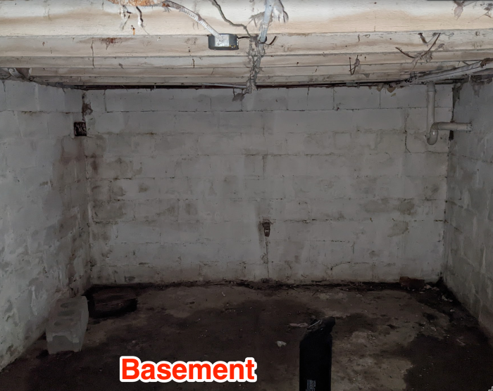

    Air sealing and insulating basements and crawls in 100+ year old houses is very difficult, but improvements can certainly be made. The very first thing you should do is deal with the moisture issues in the basement. From the moisture patterns on the walls, it looks like your roof drains are dumping water at the corners. Install extensions or some other kind of runoff drains to move that water farther from the house. Make sure your grading slopes away from the house for at least 10 feet. Clean and paint the walls with a waterproofing paint. Do some searches on other techniques to address basement water issues. With that much moisture you have significant risk of moisture related damage once you insulate and allow the surfaces to become colder.
    That dirt crawl is going to be a challenge. The "best" option is probably to dig out the dirt to the bottom of the wall (top of footing) if there is one. In houses that age, there may be no footings in in that case I like to keep the crawl floor 4"-6" above the bottom of the wall. Leveling the dirt is the primary goal here. How do you access the deeper section with the mechanicals? Hatch in the floor? Does it make sense to dig a deeper pathway between the two basements with masonry walls to hold back the dirt?
    For moisture management on the floor, install a rugged plastic sheet. 10 mil poly is OK, but you might consider one of the reinforced products that will take more abuse. Some of the professionals use EPDM or TPO roofing membrane, with roof-type flashings and seals at penetrations. these give a nice finish but are pricey. Whatever membrane you choose should lap up the walls about 6" or so and be mechanically fastened with furring strips or termination bar and sealant between the wall and membrane.
    As much as we try to minimize the use of spray foam insulation on this site, it might be your best option for insulating and air sealing, considering age and conditions. It's not cheap, but 1"-3" of closed cell spray foam would make a big difference. The foam would lap over the floor membrane by a couple of inches, extend up the wall, and cover the band joist area. If the house is balloon framed, you should install air dams in the stud cavities prior to spraying foam and extend your foam across the stud cavities to the adjacent subfloor.
    The big benefit of doing an airtight and insulated basement and crawl is that the reduction in heat loss will probably more than make up for the increased conditioned area, and you may see that the heat pumps can now keep up with the loads. If necessary, a small electric heater would probably be the best approach in winter, just to keep the basement above 50 degrees or so but that might not be needed.

    The first issue I see is signs of bulk water issues in that basement area. I'd work on fixing that issue FIRST. I see two ways to do that:
    1- Grade the external ground away from the house, and add gutters if you don't already have them. This would be the preferable option if it's possible and is sufficient to solve the problem.
    2- Put dimple mat against the walls, sealed at the top, and put a perimeter drain in around the bottom to collect runoff from the dimple mats and the floor. You'll likely have to add a sump pump to pump out the collected water from the perimeter drain.
    You can insulate the basement with rigid foam after you deal with the bulk water problem. I prefer polyiso for this application, and I'd leave a 1" to 2" gap on along the bottom edge to make sure the polyiso is never sitting in water.
    That crawlspace is going to be a pain to insulate, due to the tight access. I would use EPS here, AND A SKIRT due to the limited height of those crawlspace walls. Basically since you can't insulate the walls down to frost depth, you insulate the entire wall and then "continue" that insulation inwards along the floor to form a skirt, which is helpful in this situation. You could insulate the entire floor if you want, but that's a lot of material and work, especially since it doesn't appear to be a flat floor. Hopefully you don't have any bulk water issues to deal with in the crawlspace.
    I would insulate the exterior wall of the dug out area the same way as the basement, and probably wouldn't bother with the interior "walls" (are they even walls on the interior side, or are they earthen mounds?).
    The rim joists are probably best insulated with spray foam here due to the difficult accessing them for any more labor intensive methods. I'd use a 10+ mil vapor barrier on the earth floor of the crawlspace. Thicker is better here to keep it from getting damaged in the future. Sealing that into the floor of the dug out area is going to be tricky if you don't have interior walls to make nice surfaces.

      - drainage at the base of an old brick wall is problematic. The conventional treatment is to put the drains below or adjacent to the footing but you can't do that in walls without footings - the water flow can move enough soil to undermine the foundations. Probably not an issue with the block walls in the basement, but with old houses you never know.
      -I don't like the idea of a skirt of foam extending into the crawl space across the floor. This reduces heat flow from the house that is currently probably keeping the soil under the walls from freezing. With no footings and an insulation skirt, the risk of frost heave increases. With frost depth footings, I have no problem with the skirt, but not for your walls.
      -As far as EPS vs. spray foam, either one will work. Spray foam is a better vapor retarder and will keep the crawl air a bit dryer. The EPS is a bit "greener" but is a little bit hard to attach to brick. The surfaces are dirty and uneven, making adhesive difficult, and it can be tough to get any of the easier masonry anchors to really bite in. Since you still need a spray foam guy for the band joist areas, I generally find it's easier to just spray the whole thing. Do what makes the most sense for you.
