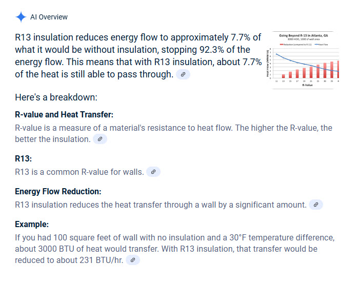

    Sound like a very expensive project in fact I think it is almost certainly so expensive that it would never recover the high cost for the small savings it is likely to deliver.
    Most likely the existing wall has at least R13 in place. While R13 is not ideal it is pretty good stopping 92.3% of the energy.
