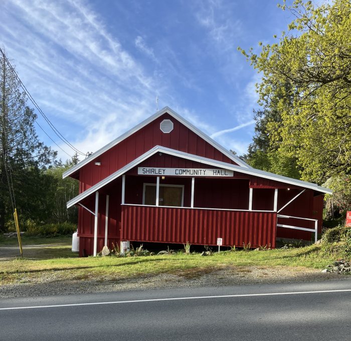

            The contractor that just finished a reno of our community hall for me said he is never doing another house build. I'm seriously considering retiring from house design.
