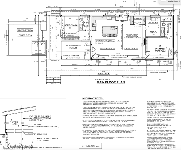

We are building a 1,300 sq.ft. cottage and would like expert advice on the best strategy to heat and cool It is a one story home with a low crawl space (max. 3ft head clearance) with 12 inch TJI (single slope) roof joists in Zone 6 and bedrock just below the surface. A few designers have recommended a dual system having an in-floor radiant system with a forced air system as a back-up should the boiler go. There is no propane currently on site and have concerns due to long driveway and access issues to fill in winter with no one around The place will no be used in the winter for the most part so thinking that maybe the water lines could be drained and possibly the heat tuned off? We are not fans of forced air heating and are thinking about mini-splits along with a wood stove, and some sort of in-floor heat in the the 2 bathrooms. That being said I don’t like the look of the mini splits with all the pipes running on exterior and a conditioned crawlspace provides plenty of opportunity (thinking combining HRV with heating/cooling?)

  3. begreener | | #4
    BTW - Great design (except the lack of closet space) ...
    I'm considering something similar
    1. amateurguy | | #6
      Thanks Begreener! It took many, many reiterations before we got there
      The draftsman put in those "Rod and Hangers" in 2 bedroom but will actually be a built-in
      Going to try and do this without a GC.....
  4. Expert Member
    MALCOLM TAYLOR | | #5
    amateurguy,
    I may be misreading the drawings, but it looks like the only place where you have adequate depth of cover to keep to keep footings from freezing is at the bermed area near the main entry. This may play into your proposed strategy of leaving the building unheated during the winter, as that will increase the depth below grade or insulation you need to protect them.

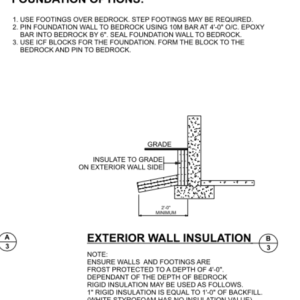

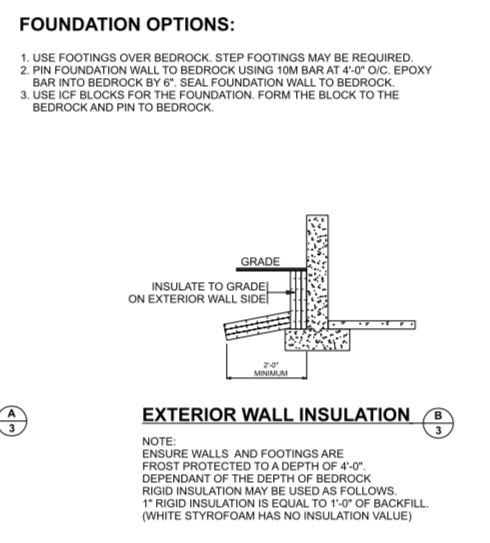

    1. amateurguy | | #7
      The bedrock is just below the surface so my designer recommended the attached detail
      Not sure that solves the freezing problem? if not and we do not heat place in the winter, wondering what the implications are for humidity inside and it's impact on the interior/
        MALCOLM TAYLOR | | #8
        amateurguy,
        It will be fine on rock. I was just going by the section.
        Lots of summer houses don't get heated all year. Some of the contents suffer a little - magazine pages and bedding smell of mildew a bit - but the houses themselves seem okay.
