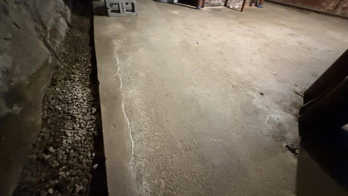

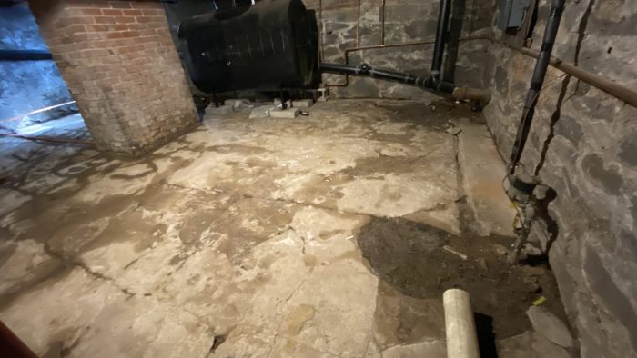

I am looking for advice on the best way to reduce humidity seeping up from my unfinished basement floor of my large, Second Empire Victorian house in Western Massachusetts that was built in 1882.  The basement is unconditioned space.  The basement walls are fieldstone and then brick foundation. Part of the basement floor is concrete, and part of it is Rat Slab (see photo below) that has lots of cracks through which humidity and moisture percolate up.  The concrete floor is usually dry but sometimes it’s damp or wet which I suspect is a combination of condensation and in a few places where there are cracks water seeps up from the ground.
I have two good French drains along some of the walls each with its own sump pump, although where the French drain is, the stone was never cemented over (see photo below). Along key parts outside of the house I had grading done in which rubber was installed three feet below grade and then drainage pipes and stone. The drain pipes take the water far away from the house.

For the Rat Slab part of the basement, I plan to install another trench drain where the fieldstone foundation meets the floor, and at the lowest point of the Rat Slab. I plan to cover the Rat Slab with 20 mil polyethylene, making sure the edges are sealed down. I don’t think condensation collects on this part of the basement floor.  Does this make sense?
Attached are photos of the Rat Slab, and the concrete floor that some times is wet from condensation and water seeping up occasionally and in this photo you can see the stones of the French drain.

    That said, if you have a system of drainage -- which you do -- it's legitimate to have a horizontal drainage plane under the floor to direct liquid water to the drains. It's really no different from having a layer of gravel under the concrete. Do I think channels in foam would work well for that? You won't know until you try, but my feeling is not. If you look at dimple mat, the dimples are about 1/2" and occupy about half of the surface area. With a drainage plane you have to worry about it clogging and I suspect that configuration minimizes the chance of clogging. I also suspect that if you were to cut away half of the foam for drainage channels what remained would be too weak to support a floor.
    I think you'd be best off using a dimple mat intended to be used as an underlayment. Something like: https://waterproof.com/product/baseshield-drainage-dimple-mat/
