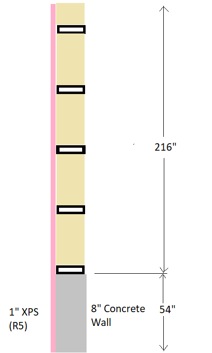

I have a large building (zone 4) where the bottom 54″ of the wall is a concrete stem wall, while the rest of the wall (18ft tall) is a steel framed all.  I am trying to determine a good target R value for the wall above the concrete.
The plan is to insulate the concrete stem wall with rigid insulation before installing a veneer, but I only have the space on the outside to go so far (roughly 1″ or R5).
Is there a good rule of thumb for R value targets in situations like this?  In case it matters, the way I am currently building the wall with rigid exterior and cavity fiberglass insulation, I expect to get to about R12.

      Not a living space, but a space I want to keep >50F during the winter and possibly even cool/dehumidify during the summer as needed. I just didn't know if there was a rule for diminishing returns when you have an appreciable amount of the wall with a relatively low R value. I didn't know if there was a "good enough" value for the wall, then focus more on ceiling/roof insulation.
      It is true that the insulation between the girts is largely negated, but consider this: I can get R19 unfaced fiberglass insulation from a local bulk vendor for around $0.35/sqft. Doing the wall calculation, I found that the R19 ends up being R7 due to the metal framing. Sounds like a waste, but considering that 1" of XPS (R5) goes for $.60/sq ft and requires eating up interior space, the fiberglass in the cavity still seemed worth the money.

    For a semi conditioned building on zone4, there is probably no ROI on going above what you propose. The steel is a big thermal bridge, so that section of the wall with batts would about an R5 assembly. If you have not already built it, I would swap the steel for wood which would double the assembly R value there for pretty much free.
    The important detail is getting a solid air barrier over the building. A good air barrier generally requires minimal extra materials and a bit of elbow grease but has the biggest impact on heating load. In your case, I'm assuming that would be the rigid, make sure to tape all the seams with a quality tape and seal the rigid to your foundation with acoustic caulk on the bottom. Not sure what your ceiling will be, but the wall air barrier should be continuous across your walls at the top to the ceiling air barrier.

    I appreciate all of the feedback. Yes, the exterior layer of foam is glued/taped continuously to give a good air barrier. Also, on top of the XPS is a layer of house wrap just for good measure.
    From the feedback, it sounds like my targets are reasonable. It is tempting to try and put some kind of layer of foam on the inside of the wall girts before the wall board (be it plywood or sheetrock) just to get me to around R17. Not sure it is worth the hassle and money.

      Why not install the rigid on the outside? You can install it over the house wrap as is.
      1. Midwayman | | #8
        Akos,
        I do have 1" of foam underneath the steel siding and outside of the girts. Is that what you are referring to? Or are you suggesting putting a second layer outside?
