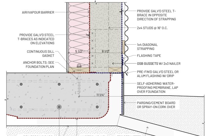

I am building a double studded house (9′-9′.6″ walls) in central maine zone 6.   I am wondering how you effectively install a vapor barrier on the exterior of the interior wall when there are gussets connecting the interior and exterior walls.  The design from inside to outside: 1/2″ Drywall, Double 2×4 studs with total Rvalue of R44, dense packed cellulose, Siga Majrex 200 for a vapor barrier attached to exterior side of interior 2×4 wall, 4.5″ cavity space, plywood gussets, 2×4 exterior wall, 1/2″ plywood sheetings, taped seams for air barrier, Siga Majvest WRB, Waterairvent horizontal strapping, LP board and batten
Questions:
1.  How do you have a VB on the exterior side of the interior wall with gussets?  I assume the interior wall needs to have the VB installed and wrapped around plate/header and taped prior to standing and nailing into place.
2.  With DPC, I would assume with a 11.5″ cavity that DPC needs netting between every other bay to achieve the 3.5-4 pounds per cubic foot?  Not sure how this is achieved with a VB on the exterior or the interior wall.  And is the Marjex200 sufficient to withstand the installation of the DPC to achieve the pounds per cubic foot?
3. Is the VB needed on the exterior side of the interior wall?   Or better to place between the Drywall and studs or not needed at all?
4.  Or if the VB is required on the exterior side on interior wall, should blocking be used instead of gussets to prevent twisting, but still an issue with netting bays.  My current house, the studs twisted, so blocking or gussets I believe should be used on this house.

    In most cases, the plywood gussets are just there to keep the studs from moving too much, so you don't need many of them. Then insulators just blow the whole cavity with dense-packed cellulose or wood fiber, through Insulweb. Then you can install the vapor retarder over that and install the drywall. I can recommend a local insulator familiar with dense-packing double stud walls if you don't have one.

        1. Yes. I forgot to mention, just be sure to make the sheathing layer as airtight as you possibly can. You only need one really good air control layer in an assembly. Adding more is usually a good thing, but you mainly need to stop air from moving through the assembly. In most cases, drywall reduces air flow from the interior space into the wall assembly, without special measures.
        2. It depends what your stud quality is. Usually ten footers are better than eight footers. I would probably install 2-3 per stud, just on one side of the stud, they don't need to be in pairs unless your studs are very twisted.
        3. I don't have experience with that. I would not be comfortable having the inner plate not fastened to what it's sitting on. I would consider using a wider bottom plate, even though you'd lose some BTUs, rather than compromise the structure.

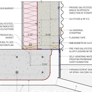

  3. JMRtbay | | #3
    My architect and I have designed a similar wall based off of this > https://ca.475.supply/blogs/design-construction-resources/the-double-stud-wall-simplified-low-cost-high-performance#:~:text=The%20wall%20consists%20of%20an,loads%20meet%20the%20design%20criteria.
    I attached a screenshot of my drawings showing the gusset details. To maintain the continuous smart VB on the exterior side of the interior stud wall a “nailer” will need to be used to attach the gusset. This will likely need to be done from the exterior (will complicate things in a multi story build). My carpenter and I will be figuring out how to actually build this in the next couple months.

    1. JMRtbay | | #6
      *edit* -sorry I just realized your response was directed towards the OP…below are my reasons.
      It makes it more resilient and will be detailed as an air barrier. The inner stud bay can serve as a service cavity (which will also be insulated later). No plumbing or electrical will penetrate the barrier. Future renovations will also be less likely to mess with it.
      It may be a detail that many would never pay the extra labour for, but for me (and many others) I’m good with it.

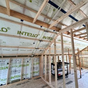

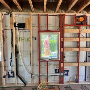

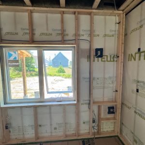

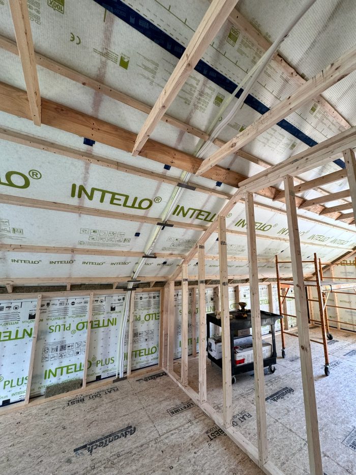

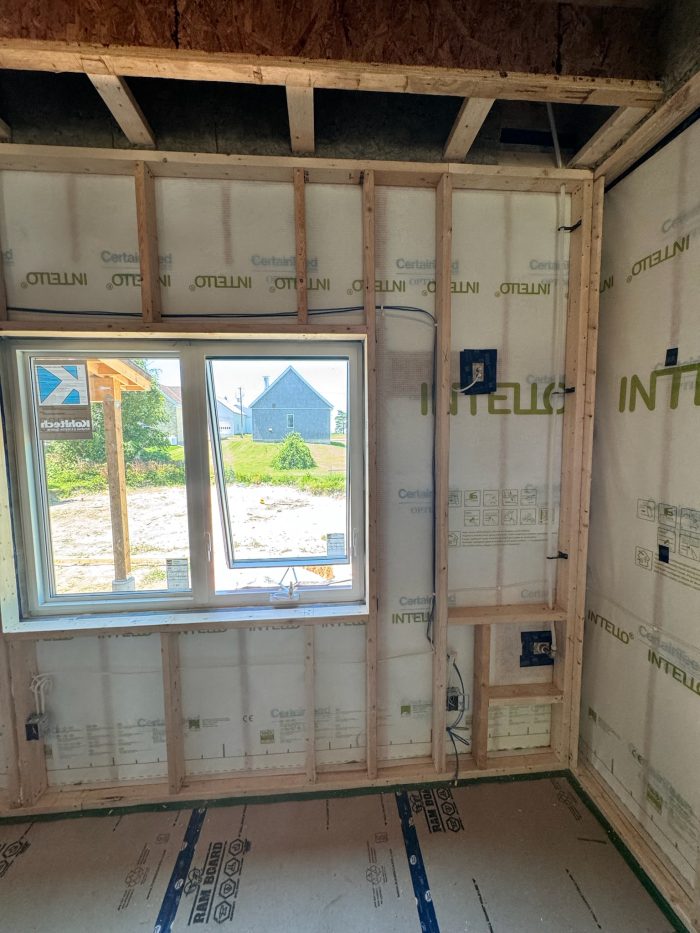

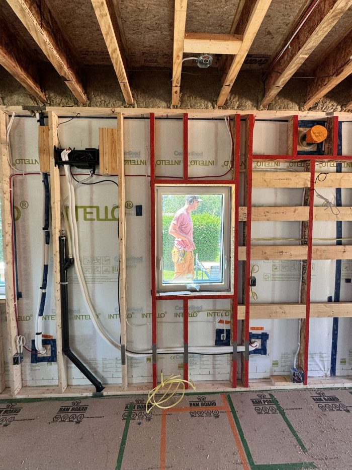

  7. sommerbros | | #18
    Hi Sean, I’m a builder located in southwest Ontario CZ 5/6. We haven’t managed to convince our building inspectors that a vapour control membrane may not be necessary so we chose an vapour variable membrane like Majrex or Intello which satisfies our officials.
    Our preferred double wall includes a protected vapour/air control layer as you are describing. After researching various DW assemblies and not seeing a build up that checked the performance and build-ability we developed the
    following assembly and found it very builder friendly and straightforward to sequence. Here goes from exterior to interior
    Siding (horizontal)
    1x3 vertical rainscreen
    Zip sheathing (primary air barrier)
    2x8 at 24”oc
    R32 Dense pack fibreglass BIBS (could be cellulose or batts)
    Vapour/secondary air control (ie Intello or Majrex)
    2x4 at 24” oc service cavity wall
    R14 BIBS*
    Drywall finish
    The use of 2x8 does add some material cost but little to no additional labour cost. The reason we specified a 2x8 exterior wall was to push the vapour control inboard, similar to the location you describe. Installing the VC on the interior of the exterior wall was very simple and should be very familiar to many builders. The 2x4 service cavity wall is about as easy as it gets and you are only left with a handful of through wall penetrations to deal with (hose bibs, outside receptacles etc)
    One of the best aspects of this assembly from a builders perspective is that other than adding an additional wall for services there is really nothing unusual and mechanical, electrical and plumbing trades really don’t need to understand it as they have very little interaction with the air/vapour control layers resulting in easier quality control.
    *Our insulator is close by so making two trips wasn’t an issue. We would choose batt insulation for our SC wall scheduling a second trip from insulation contractor was too complicated.
