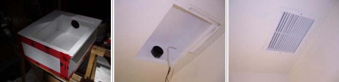

    Rather than go to a gable end, If the soffits are boxed-in the easiest place to exhaust is near the fascia using a directional termination that will throw the air past the overhang.

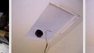

    However, I now do something similar to what you are proposing for different reasons. To both make air-sealing the fan enclosure simpler, and to keep the duct connection easily accessible if the unit needs changing, I mount bathroom fans in an air-sealed box. You could easily make it taller and do what you described. You do need to buy a separate, larger vent cover.

      That's pretty neat, Malcolm. The box looks to be rigid foam, unless I'm misreading the photos.

        The box is plywood, sealed and painted, with a wood face-frame to seal to the ceiling drywall. Foam alone wouldn't work as there would be nothing to mount the fan housing to. I line the outside with foam board if it is going into a roof space. I also use these in the floors between stories.

    Malcolm, do you have any pictures of one of your boxes with a fan installed in it? I'm fuzzy about how one gets attached.
