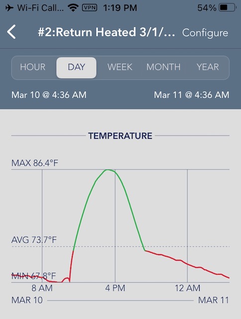

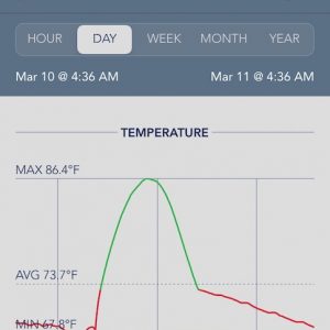

    I hope I've explained it well. Please post further questions & corrections, and I can post the actual data if anyone wants. For now I'll post a screenshot of the temp curve for the heated return air. The big green parabola in the middle is when the ERV is running. The down slopes before and after it are room air temps when the ERV is off.
    best,
    Silas
